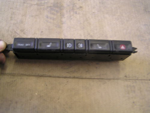

send me pics of your seat module connectors both sides and maybe I can tell.
I'll look at the wiring diagrams this weekend. And parts to see if different between years.
Graham, I think he is looking at adding the seat heater elements to the 97 car.
at least for MY2000, the center console switch pack doesn't change electrical connections as the signals are digital coming from it. Just need to get the switch pack with the heater switches in it.
1999 JAGUAR XK8 SWITCHES | eBay
http://www.ebay.com/itm/HAZARD-DASH-...571f4a&vxp=mtr
http://www.ebay.com/itm/heated-seat-...e73f80&vxp=mtr

electrical connections for 97 are same as 2000 for heaters
seat heater part numbers did not change.
