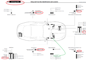

On the engine rotation , does the starter relay click or by putting your finger on it ? You can swap the relay out for a easy try . Other then that the inertia switch location may match other pic .
Pic with the green circle below :

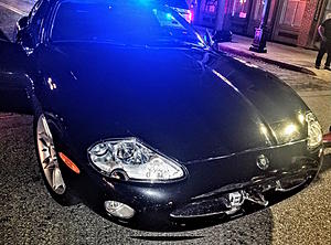

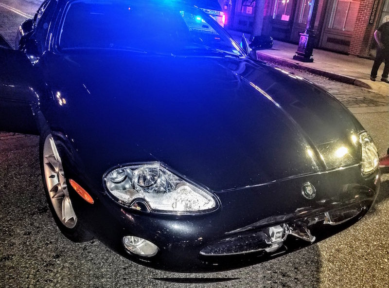

Here's a photo of the front end damage- it mostly the driver's side headlight, bumper rash and the grill. She was towed about 30 miles from me- I should be getting her back on monday or tuesday and hope to get her to start up soon thereafter and get the bodywork done.
