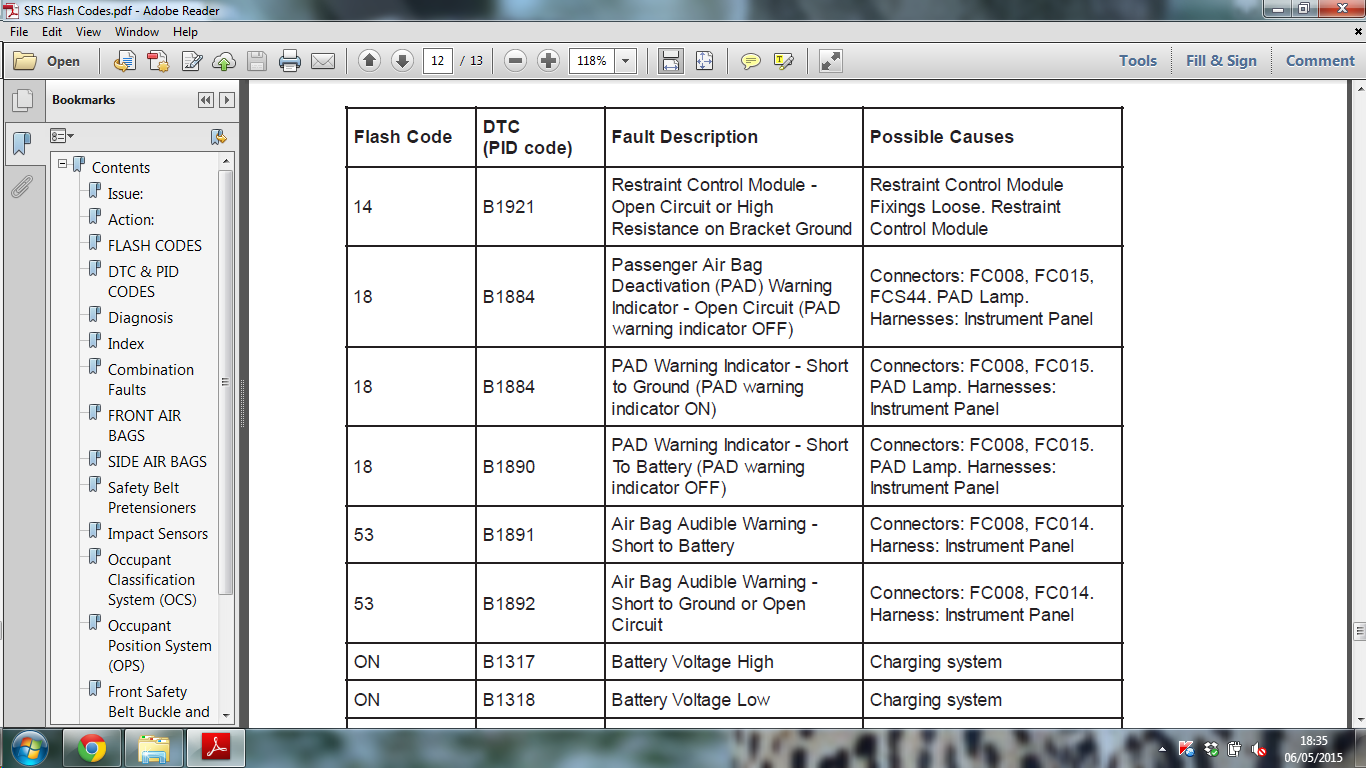

To be sure of using the right technical info, you need to say if your XK8 is a 4.0 or a 4.2. Your 02 could be a 03 MY.
Assuming a 4.2, here's the description of the probable causes of FC 18. Sounds as though there's either a bad connection or a nipped wire shorting somewhere made during your installation.

Problem found passenger side airbag light is dead ordered new light should be good to go when it comes in

HJE9682AB by the look
Part no. HJE9682AB | Warning lamp parts from Jaguar Heritage Parts UK
