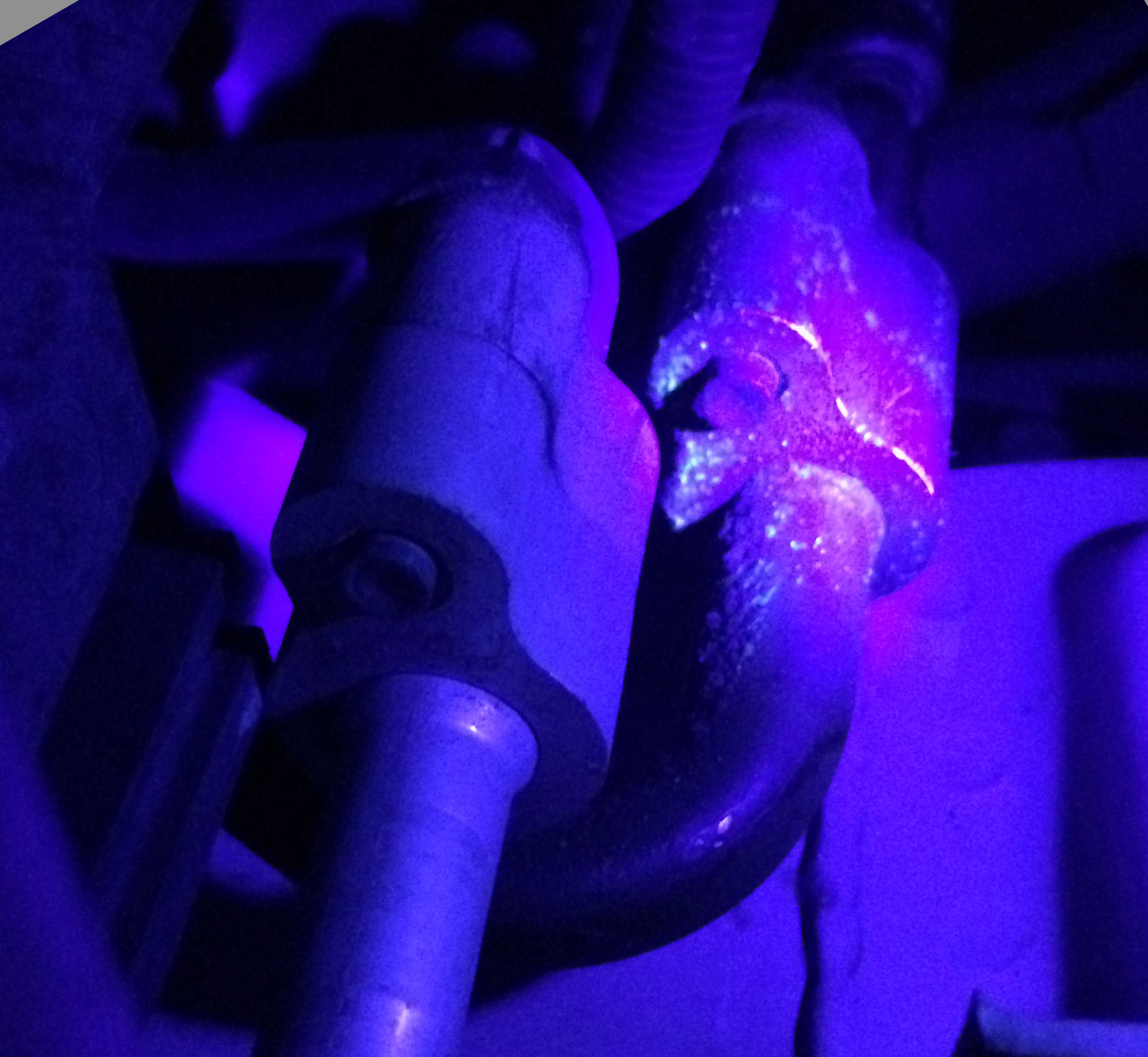

So I can't see any signs of leaking around the compressor, but there are some spatters around this receiver/dryer hose fitting. It is not very well defined, so it could be from the adjacent fitting which I think is part of the condensor.
Attached Thumbnails Are there any "typical" failures for A/C ?-ac_leak.jpg

Yep, that was it, the shop that flushed and filled the system checked it out today and isolated it to the schrader valve at the fill port. No charge to check the system and replace the valve as they said they should have just done that anyway the first time. I love honest small town shops.
The other speckles I saw were just random particles, aluminum oxide, and other material that fluoresced slightly under UV.
