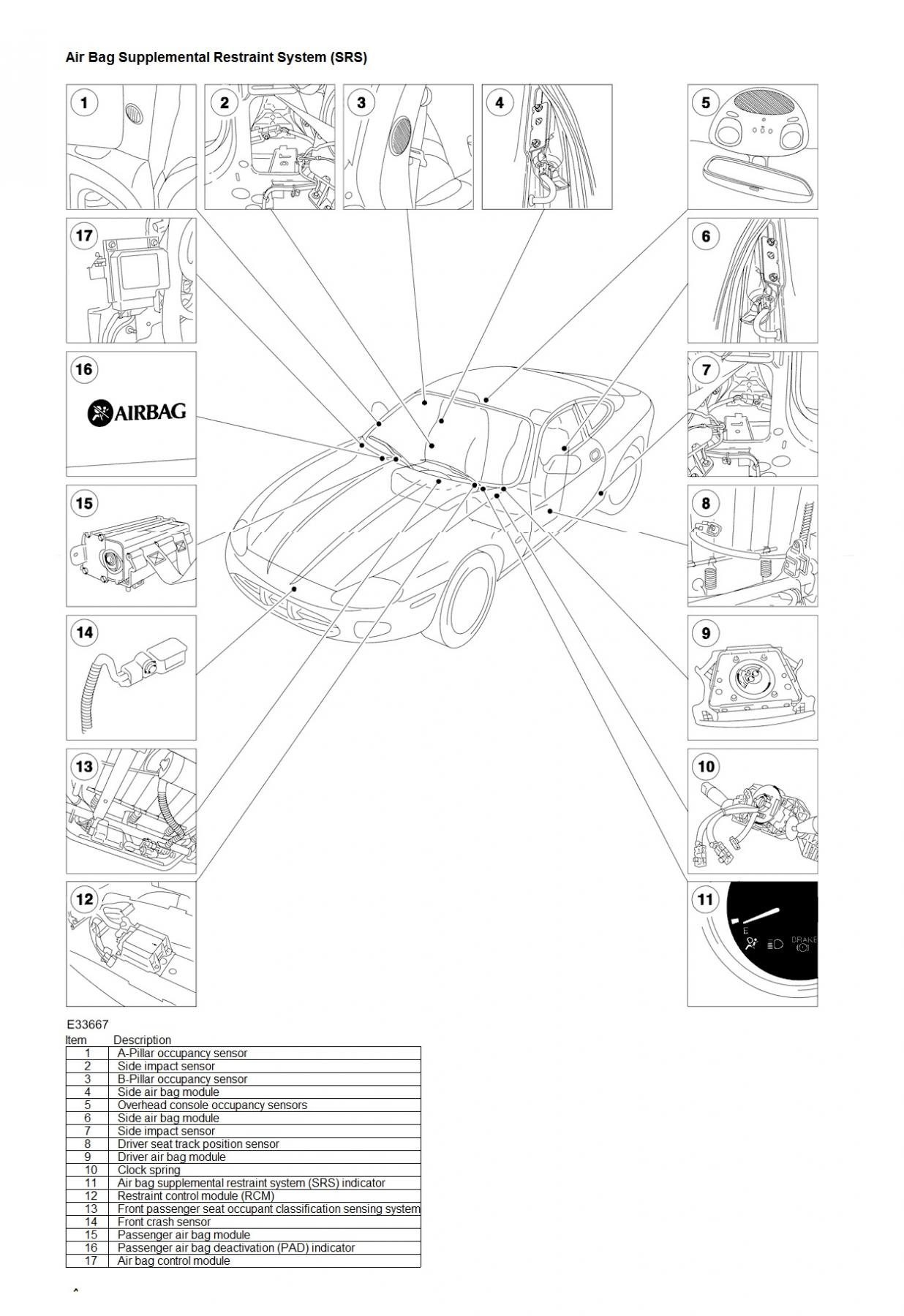

I've not had to remove or work on mine, but it looks like it's on the center line, just behind the grill opening
https://www.jaguarforums.com/forum/a...e-srs-2003.jpg
-Steve

From what I've been able to learn from past posts is that the impact sensors are two boxes mounted on the frame between the radiator and grille. It might be as simple a solution as then being loose on their mount or a bad connection at the sensor. I also read the warnings about disconnecting the negative battery cable before working on them (although I neglected to do that when I replaced the grille). In any case, hopefully the solution will be simple (it's a Jag; nothing is simple!).
