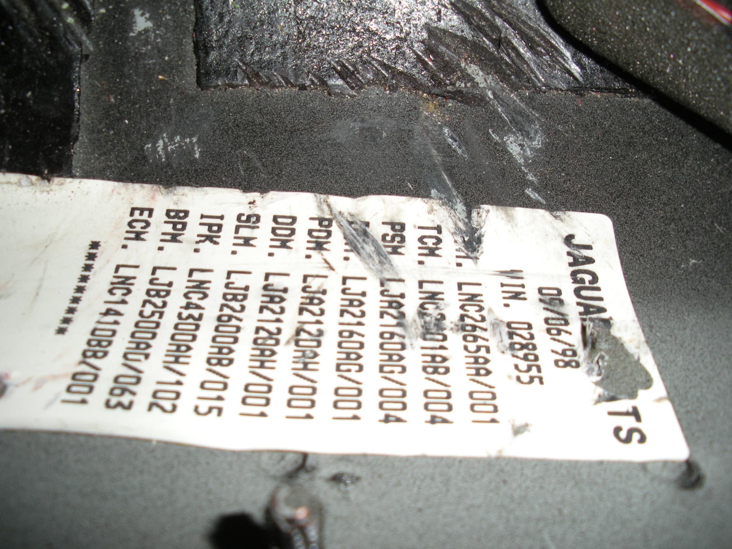

XK8 -97 US Spec
Attached Thumbnails All 98 convertible XK8 owners please read.-20131024_130950.jpg

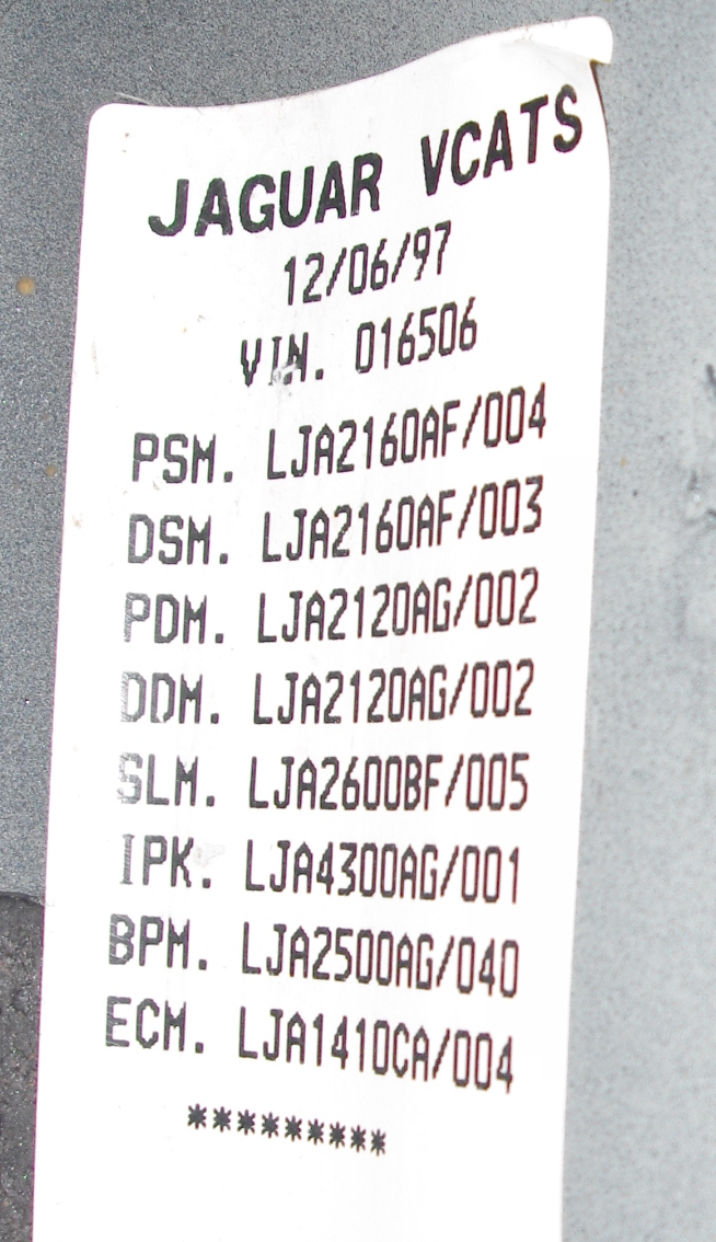

Glenn here is mine. 98 Vert Hope it helps. Picture sent as attachment?
Dave

UK Car - 1997 XK8 RHD Normally Aspirated. No cruise control, ABS & Trac.
Might help with your detective work !!
Cheers,
David.
