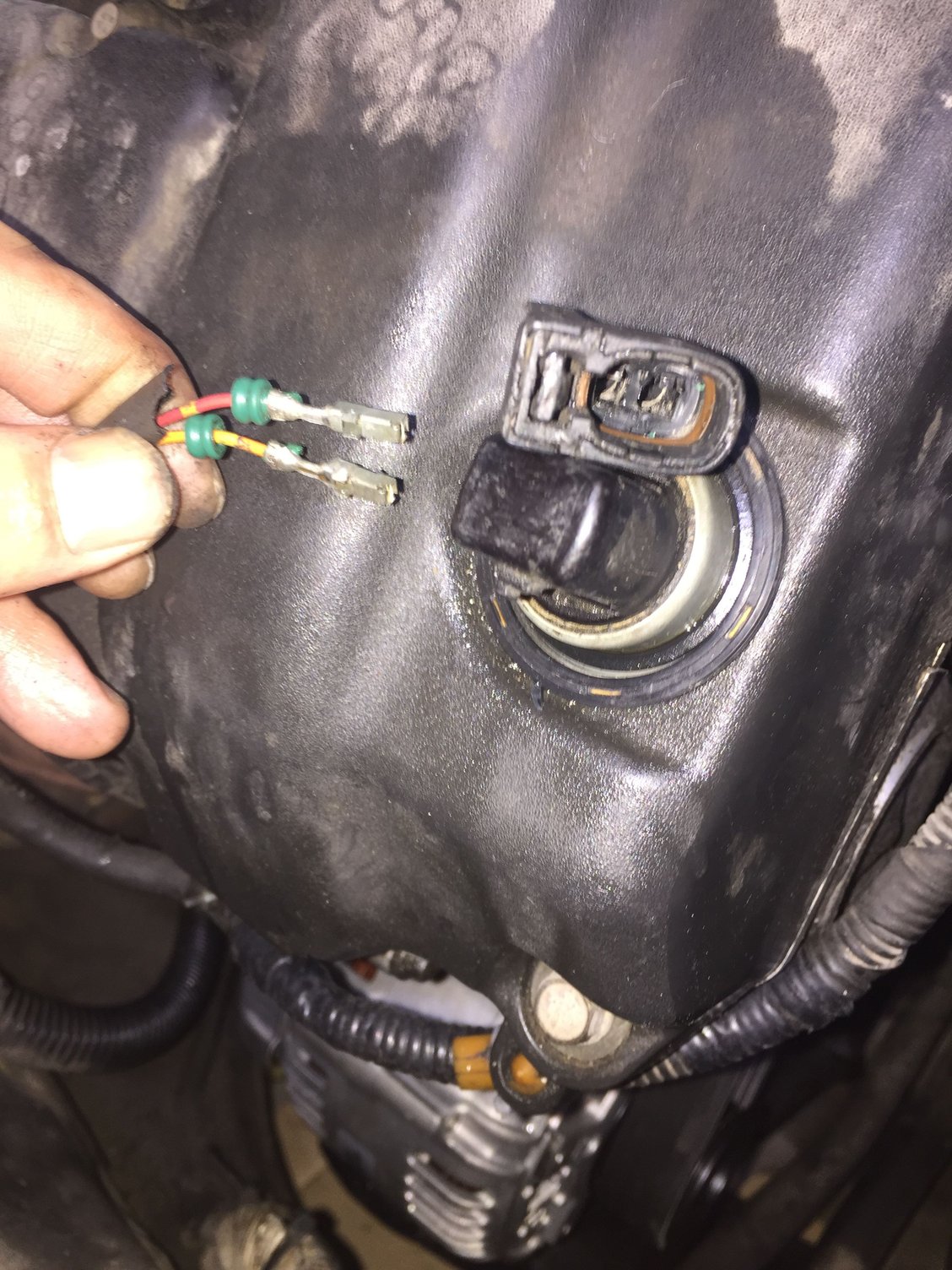

Well finished today and new alternator puts 14.2V at idle, during initial start up, compared to the previous 13.5V I got before. Let’s see if the car has any hick ups in the heat when new alternator is Hot!
Did hit one one problem during re-assembly and that was the VVT connector broke.
Anyone has any idea what type of connector this is? Jury rigged a temp fix but I want to fix this properly.

In July 2018 I ordered two of those VVT solenoid connectors for my wife's 2006 XK8 from rockauto.com. They were branded "Airtex/Wells" and the part number was 1P1792. Just over $9 each. Perfect fit and no soldering required. I believe they are applicable for all XK8 model years but be sure to doublecheck that before you source them....
