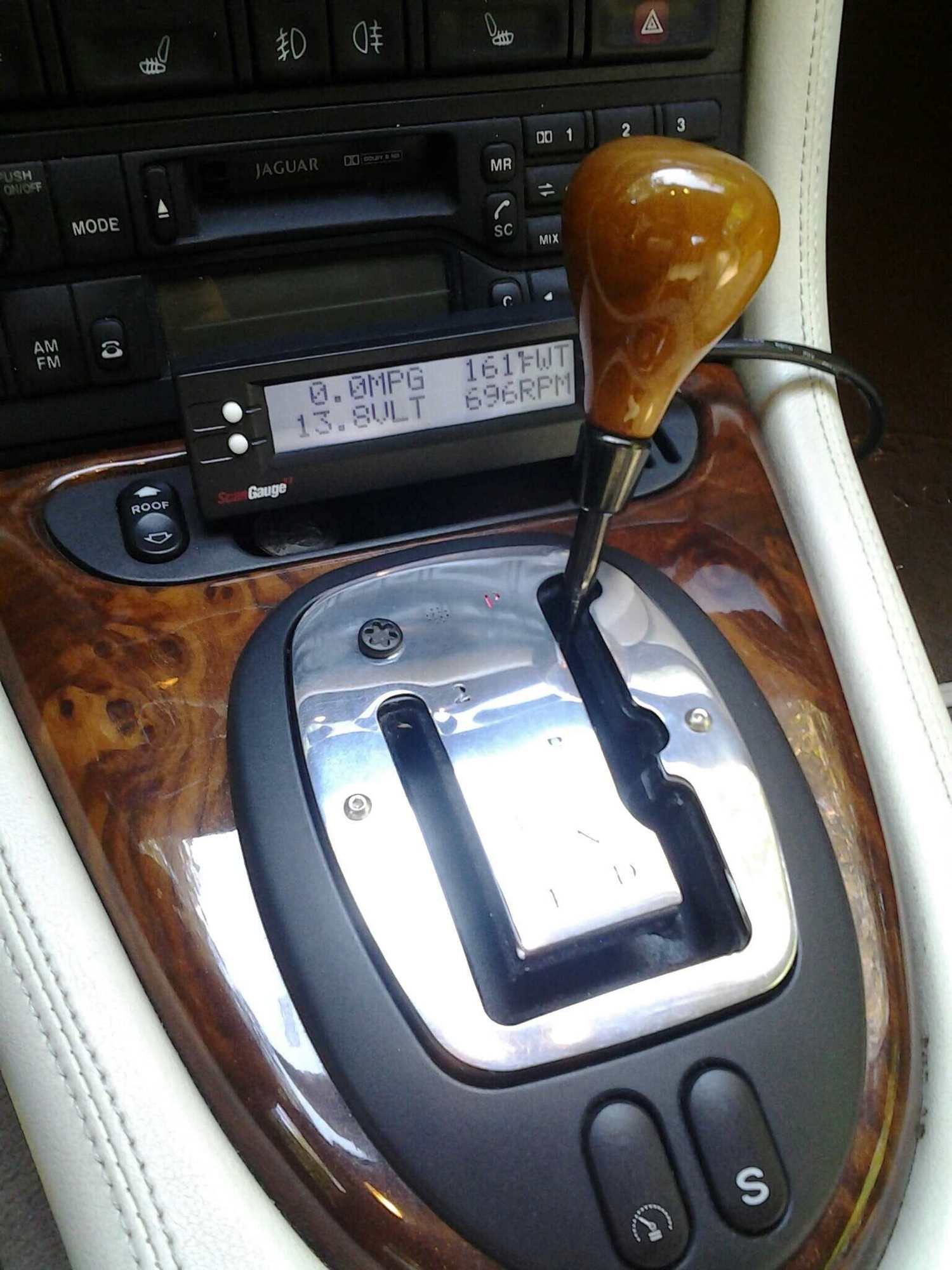

Here is the one I bought from him and installed on the XK8 I used to own a couple years back.

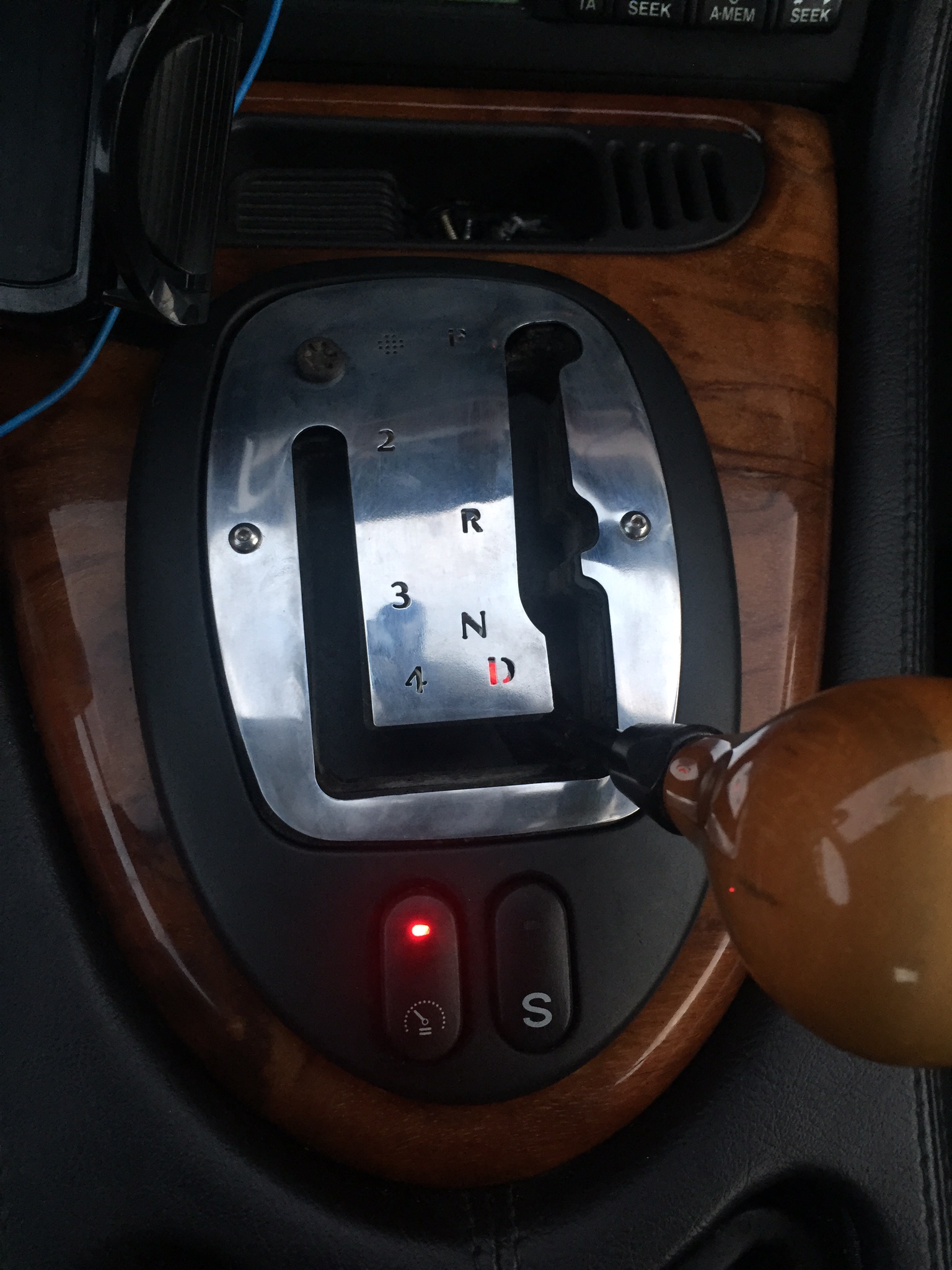

Seems to be a common problem with older XK's. Took a bit more work to install than I thought. Very happy with the results. Find my before and after, Rich.

The 6 speed plate I ordered showed up today. A very nice replacement. The shift point positions are cut out so the illumination shows through. One note if you watch the how to videos. The six speed plate is held on with 5 screws. Two tiny countersunk allen screws on either side of the plate in addition to three pointed out in the video..

Yup... Mine also arrived today.
However, oddly enough, mine was held together with No screws. I have a feeling someone has messed with that before on my car.

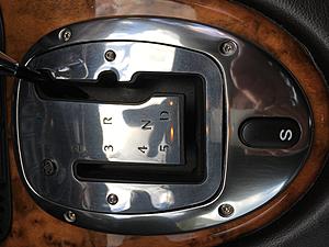

I did the 6-speed plate last year. IIRC a common error is to mount the plate onto the plastic OEM. It looks far better to remove the (broken) original plastic and adjust the alu-plate onto the J-Gear frame. I did this with two small torx screws.
Another aspect are the openings for the Gear-Indication LED's. I closed them with clear 10-min. epoxy. Just put a bit of tesa about the openings from the top-side and apply the epoxy from the back.

I have my Scangauge on the steering wheel binacle ...pull wheel towards you and this opens a gap between the wood trim and the binacle ...fit Scangauge and push the wheel back. It clamps it fine. Wire easy to conceal..goes out the back of the scangauge . Being in the UK the speedo is way out so I display MPH . You need +12 in the settings to get it to match a GPS
