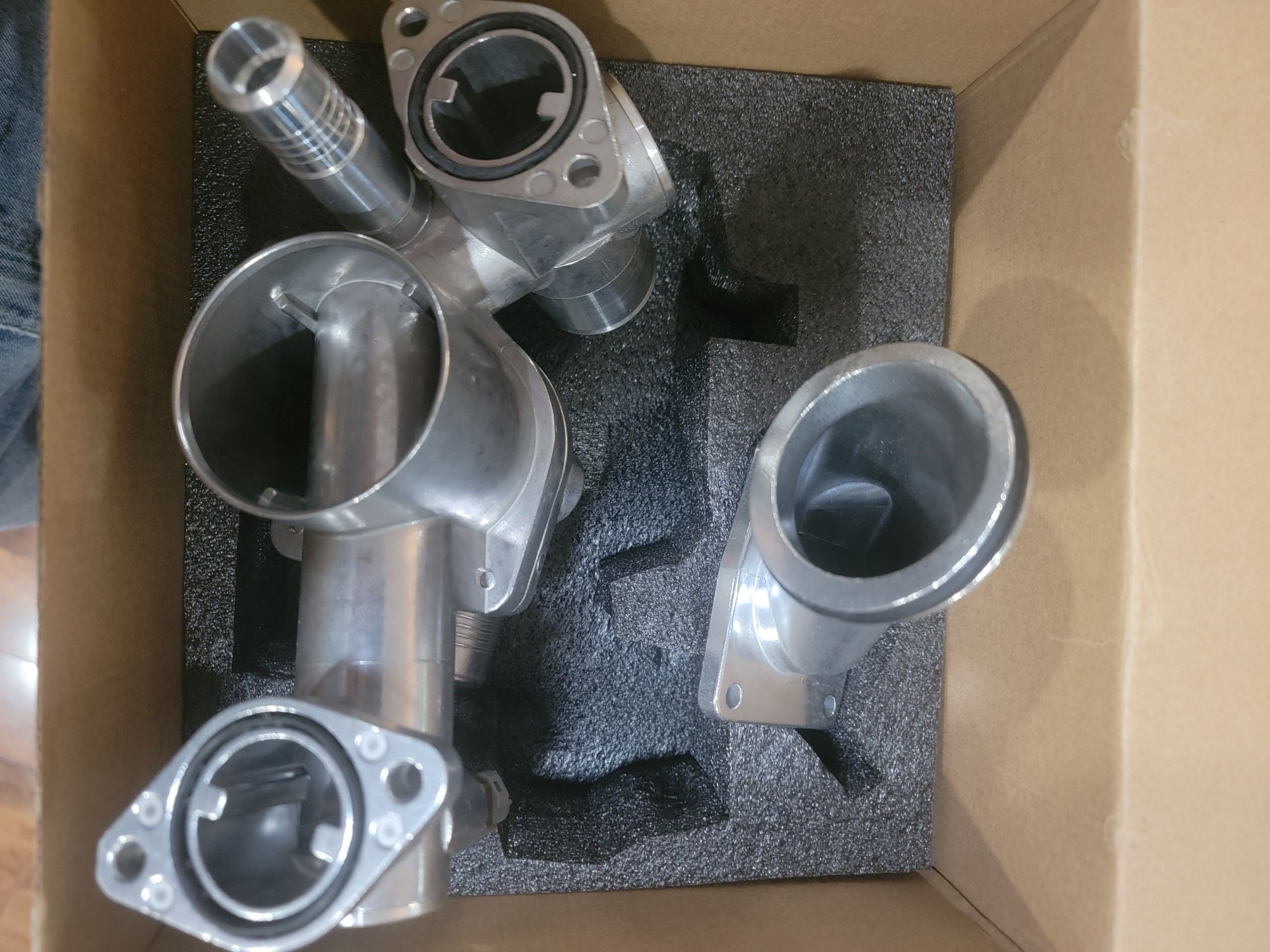

Old Dec 30, 2025 | 12:26 AM
Brian G's Avatar
Joined: Sep 2024
Posts: 178
Likes: 44
From: Vancouver Island
Got my Ebay sourced housing today. The packaging was first rate and the castings appear to be quality products. Lets hope the fitment is as good.
