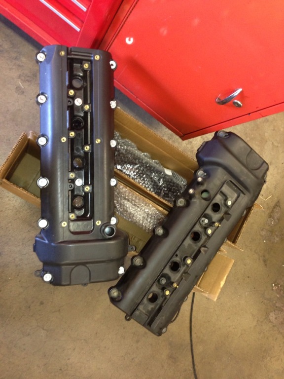

The install techs agree that we need to use the 4.0 coil packs. The cam covers from the 4.0 are quite old and don't seem like they'll close properly, so we're ordering new ones today (minor delay, but the right thing to do). We're having the parts sent overnight, so it appears that this Friday may be the new finishing date.

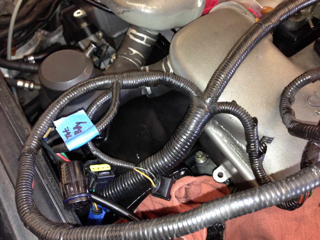

The new camshaft covers are being installed tonight! Also, the EGR is being retained and installed down by the transmission on a stock bracket.

In this photo, you can see the old 4.0 under its cam covers (150,000 miles):
In this photo, you can see how amazingly clean the newer 42,000 mile 4.2 liter engine is:

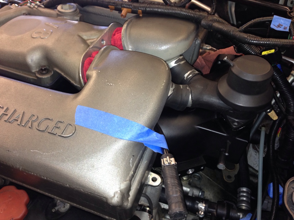

In this photo, you can see the supercharger being aligned with the other pullies:
In this photo, you can see how nicely the custom aligned (cut and re-welded) intercooler ports match the blow-off:
In this photo, you can see the other side:
In this photo, you can see the new 4.0 camshaft covers (left) compared to the old (right). These are retained so that the 4.0 coils can be utilized, functioning properly with the factory 4.0 ECU:

I thought the intercoolers needed to be shaved down on the inside by the intake/manifold area? Did you manage to get enough room without doing this? Just curious...

So far, it looks to the tech like we're OK on the fit. If we need to grind metal, we can still do that, but I'm letting him go with it for now.
Depends on the application. The intake from the 4.0 is a little different from the 4.2 and has more room, so I'm guessing that along with the cam covers that the charger coolers and lower intake manifold are from the old motor.
I have a 4.2 and had to grind the intake runners.

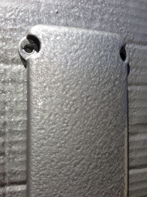

The new 4.0 cam covers are on and minor detail work got done (polishing of the words 'supercharged'). The V8 will also get polished.
I'm painting the inner panels (cam covers) today so that they look newer with a hammered grey finish.

Default $15 well spent
The camshaft cover inserts are still wet, but the look will be nice with the cast aluminum intercoolers and polished lettering. Hammered grey aluminum paint is awesome... and cheap.

Jeff,
The pics are most welcome. Please keep them coming.
And I would agree the hammered aluminum paint looks great! I've used crinkle finish before for motorcycle applications, but this looks even better. I assume since it is on plastic that no heating was required to get the textured finish?

Default No heating
Correct Jag#4,
The 'hammered' effect happens after you've gotten a few quick liquid layers applied and let it sit. It seems contrary to a good paint job, putting it on thick and wet, but it works for this type of finish. It is usually a strong, scratch resistant finish also.
