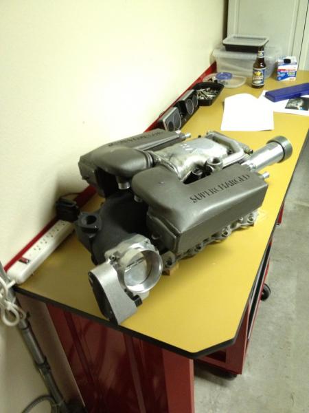

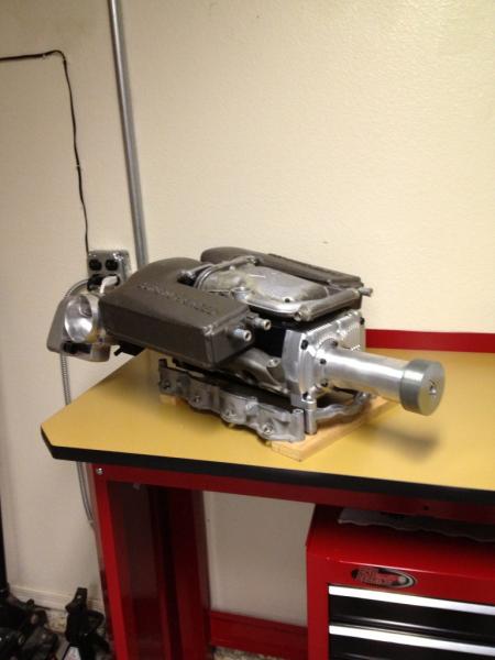

Fuel injectors are sent off for cleaning and flow testing so today was mostly cleaning up. New plugs are in and the intake parts got a chemical dip to remove 10 years of EGR junk.
I left the S/C outlet in a little too long and it took off a good bit of the paint, but that's ok, I was planning to refinish them once all the modifications were done anyway.
Bolted the parts together on the bench for a fit check and to get a feel for the modifications that are needed. Minor adjustments mostly, shouldn't be too bad. It's a nice kit that Avos has put together.

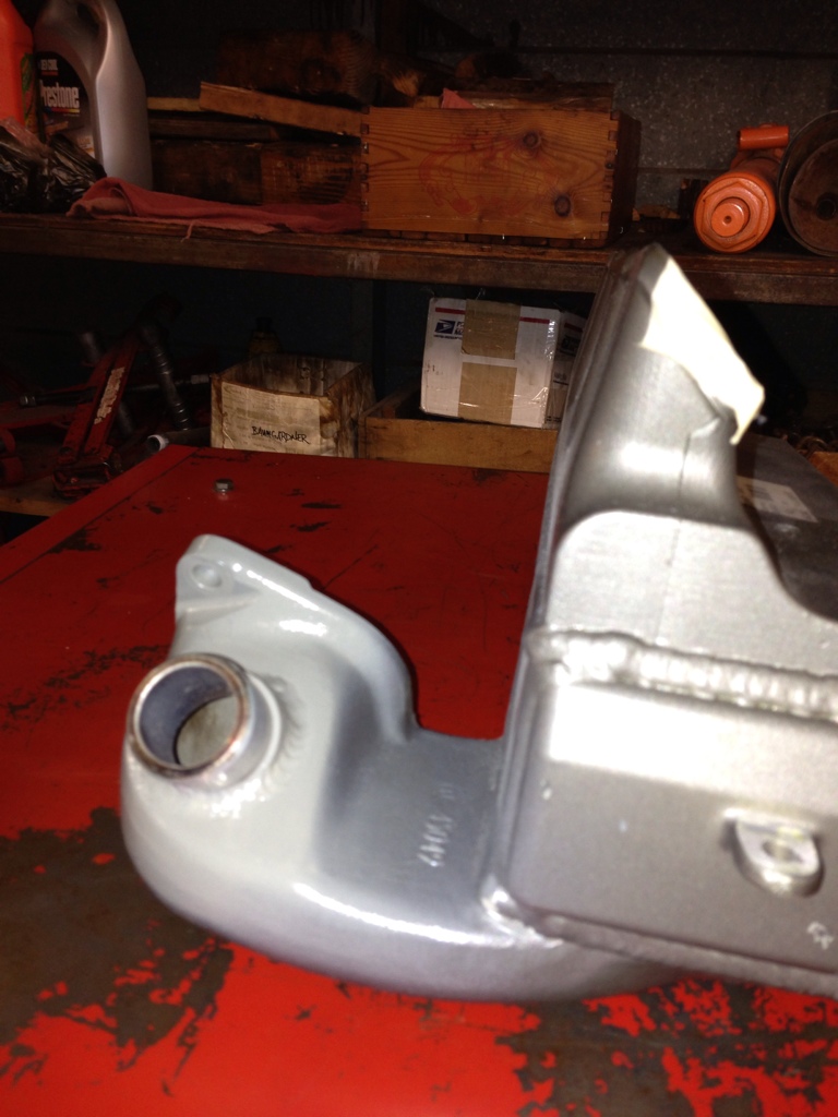

I took pics of the prepared engine and the freshly welded and altered inter-coolers.

Looking good. Did you get the intercoolers repainted or powder coated?

I will most likely leave the finish stock, except to brush the aluminum lettering in a front to back fashion with a heavy grit sandpaper.
The finish that you see applied to the welded area was put on by the welder, just in that welded area on the bottom. I believe that it is an engine enamel that is aluminum flake filled. The rest of the surface is now really, really clean.

What is the modification on the intercoolers? Something to do with the bypass valve?

Yes, the angle needs to be changed to work with the customized aftermarket unit that AVos' supplies with the kit.

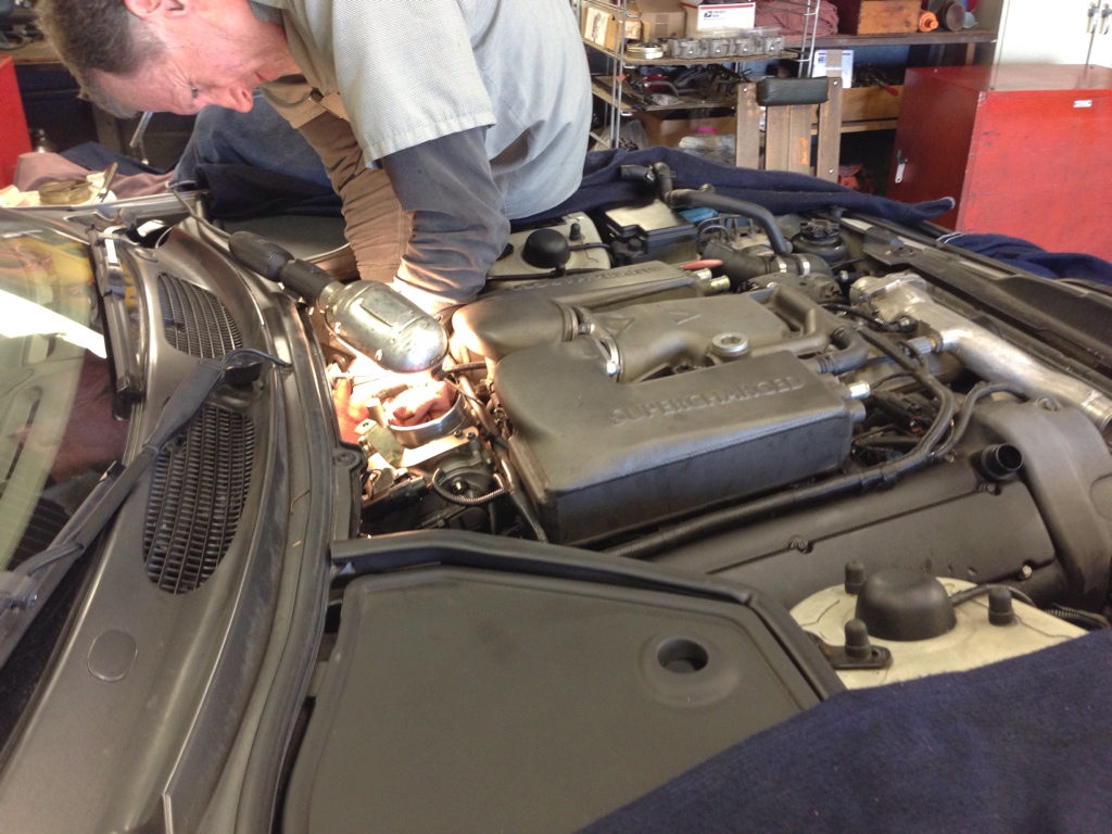

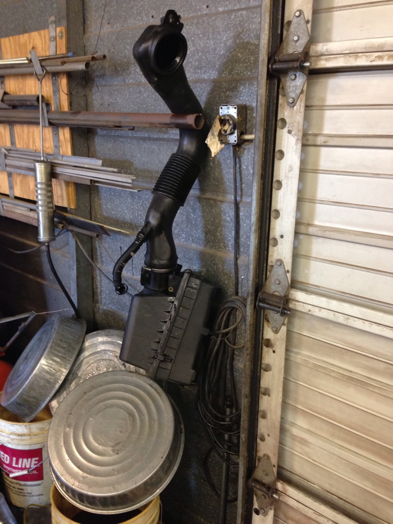

Default Hood removed
The hood is off and the process has begun. The tech is carefully removing parts and wiring. The pic of the intake (an XK8 unit modified to fit XKR so that there are no silencer tubes in the airflow) shows it over an oil pan to catch the oil that had collected inside. Yuch! There was a LOT of blow by past the worn piston rings (just a few miles short of 150,000 miles on the original 4.0 engine).
Attached Thumbnails Another Avos Twin-Screw Supercharger Kit in USA-6cf9e188-1cdc-48af-b18b-7043f899d5aa-6884-000003f9f06438fd_zpsf0b889c9.jpg   Another Avos Twin-Screw Supercharger Kit in USA-70ee0fb6-9569-4252-8d03-0bfa783fcc2d-6884-000003f9edcbe36e_zpscdc62fcf.jpg   Another Avos Twin-Screw Supercharger Kit in USA-e0e6d5f2-d7ff-403a-9772-bce0e4930282-6884-000003f9ea951544_zps22bbe7cf.jpg

Did he throw that trouble light at you for taking pictures while he had his arms jammed into that little space while trying to undo bolts?
I have a lot of respect for Maxwdg having taken that thing apart and put it back together so many times. Not fun.

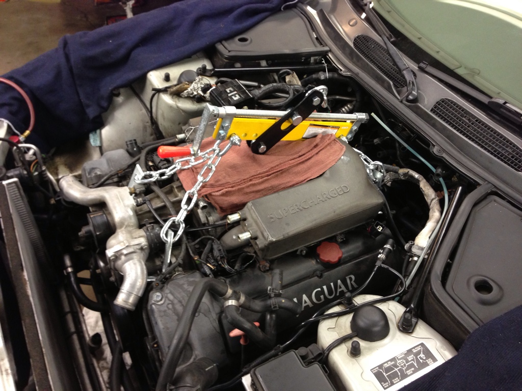

I had forgotten something in the Jag's glove-box, so I stopped by Falconworks to get it. They are almost ready to lift the old, tired 4.0 out of its home.
Oil leakage and blow-by oils had softened up a few rubber hoses, some of which were fairly new, so those will be replaced.
The catalytic converters are out and on a table. They are in great shape. I'll re-use them. At this point, with so much power that is going to be available, I'll wait to consider adding a set of Nameless cats. I think that the car is already slightly loud with the removal of the rear mufflers and I don't want it to become obnoxiously loud. I would like for the supercharger whine to be louder, though! I love that sound.
