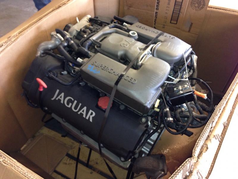

It arrived in great shape. I wish that they had not strapped steel directly against the engine parts, but it appears that there is no major marring. The engine looks spectacular like a 42,000 mile engine should. I felt like I was looking at a work of art. =)
The engine is at Falconworks where Jaguars of every kind are right at home. The engine and supercharger install will begin in approximately 2 weeks.

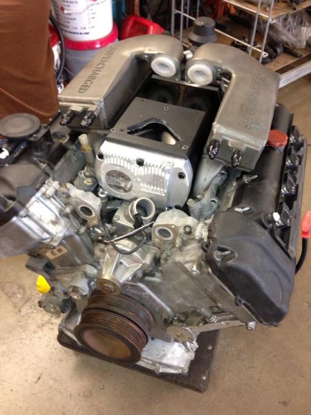

Having just started the same project this last weekend I can say that doing this surgery on an engine stand rather than in the car is going to be WAY easier.
I couldn't resist taking a pic of the new and the old supercharger sitting next to each other on the bench. The KB is just a wee bit bigger...
Attached Thumbnails Another Avos Twin-Screw Supercharger Kit in USA-ccfulton-112833-albums-upgrade-6511-picture-blowers-16998.jpg

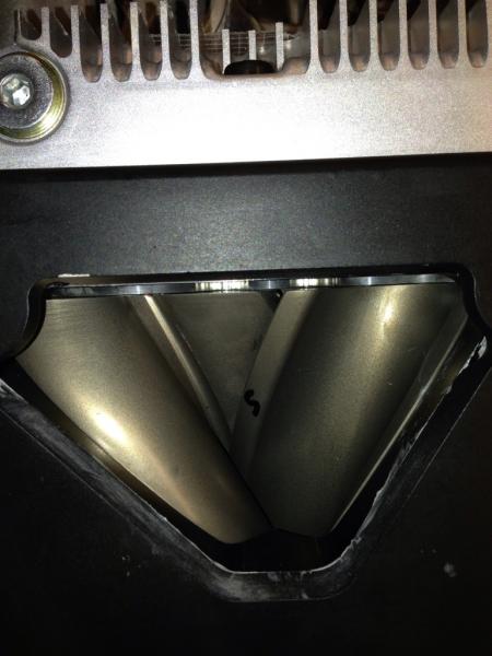

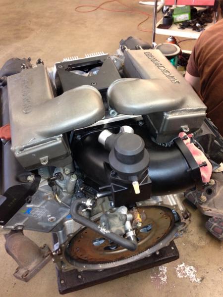

Default More work done...
The supercharger has been fitted and cuts made to the intercooler connectors. They will be repositioned and welded back on.
More later. =)
Inside supercharger:
Attached Thumbnails Another Avos Twin-Screw Supercharger Kit in USA-27dfceb8-74ac-46ff-ad97-e14b00fbf346-9638-00000620adb1df46_zps7894e28f.jpg   Another Avos Twin-Screw Supercharger Kit in USA-35cf5dd2-af14-44b4-ad65-e581a0b3159c-9638-00000620aab5a451_zps3d001bfb.jpg   Another Avos Twin-Screw Supercharger Kit in USA-dcb9393e-29da-4d25-9cbb-bdc214344ddd-9638-00000620a75d0386_zps86b42008.jpg   Another Avos Twin-Screw Supercharger Kit in USA-8e6ac3e5-2edb-4832-a365-9d6d603ed284-9638-00000620a40de025_zpsd46f4665.jpg
