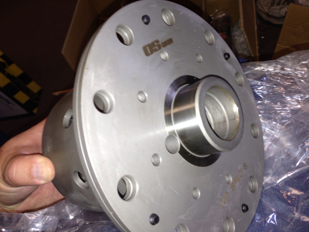

I don't have the nicer camera set up yet. I might be able to do that today and get a program that allows me to edit the feed. That would make something more fun to view!
The purpose of this short video is just to show you what is going on without having the limited slip differential installed yet. With nobody around, I hit the gas at a stop light (no entering driveways ahead, either). I paid more attention to going straight than pointing the camera in the right spot. Hah!
You can see by the flickering of the yellow light on the dashboard that the traction control was trying to do its job all the way up to 50 mph... on dry pavement. Laying down a decent 0-60 mph time will be possible with the LSD and wider wheels, plus learning to modulate the throttle properly.
'Sorry about the bad video quality, but I'm not trying to win a video production contest. I hope that these type of short videos help to convey what the car is like. =) More L8R.

The blue tops are not installed yet.
Those are going to be installed in a few weeks when the new differential goes in.
At that same time, I'll have a 2.75" pulley put onto the front of the supercharger to replace the 3.25" unit that is on there now. Yes, the car has more power coming.
After doing some more reading, I decided to turn the water/methanol injection back on. I did that on Sunday morning. The result? The tires just spin faster before shifting into 2nd. It is starting to get hot in Tucson, Arizona, and 105 degree temperatures are only about 6 weeks away.
With the new blue tops, pulley, and LSD installed, the car will also have its new shoes. The 20" Perseus wheels with 9" up front and 10" in the rear will hopefully help to put down some of that power in the form of traction. Haaaaaaah!
I'll need to get an awesome set of brakes after that.
