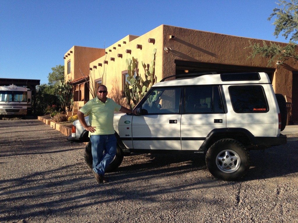

Sorry for not being very active lately. In December my pinion gear decided to
disintegrate. Hah!
The car will be back together in about another week.
We didn't shot peen the gears prior to the installation of the OS Giken differential, like AVos had recommended.
Lots of research lead us to determine the best way to put things back together. Falconworks found a specialty shop in Los Angeles that does exactly what we needed. We paid $1,000 to have an analysis of the metal done. We sent them chunks of the broken stock Dana pinion gear for vaporization. With those results, they have determined the correct way to harden a new set using heat treating and shot peen techniques. Prior to sending the new set to the vendor, Falconworks took off all sharp corners from a brand new set of gears.
We'll see how this one holds up... they say that I should be able to beat on it pretty hard without grenading it again. When it popped, I had just come out of a corner and was laying down 2 patches of rubber as I accelerated. The XKR has become quite a rubber patch laying machine. Someone has to seal the roads around here!
I got bored while waiting for the XKR gear work, so, on my Land Rover, I cut the fenders and added flares, over sized tires, and heavy duty high-clearance bumpers with a winch. I've been going places that I'd never point the Jag at. This rig has a locking rear diffy, too. The rocks that it can go over are huge!
Attached Thumbnails Another Avos Twin-Screw Supercharger Kit in USA-null_zps79c3b98c.jpg
