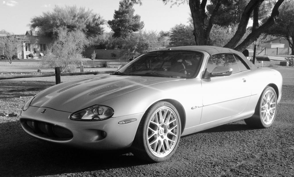

I've got the Jag back, but need to break in the gears prior to doing the dyno run. Soon!
(Good LORD, this thing is fun to hit the throttle on)
