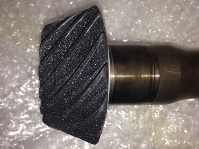

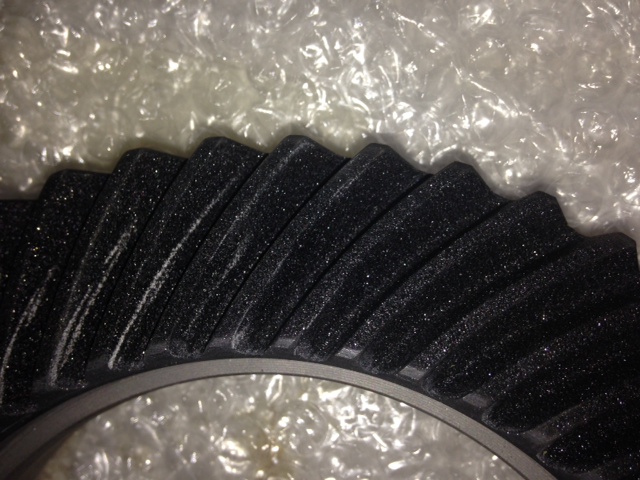

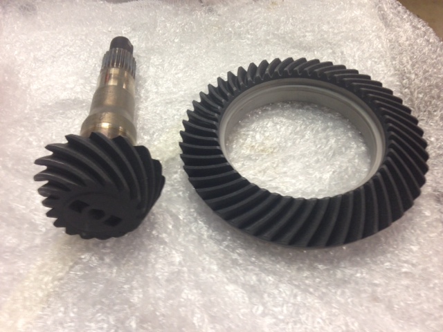

'Sorry for the long delay between posts. It has taken a long time to have these custom gears made. As usual, I had the techs at Falconworks do the work. They did lots of research to determine the appropriate shop for the gear work. Falconworks bought a new set of ring and pinion gears, then rounded off all corners and points. The metals modification company then had to vaporize some metal from the original broken gears to determine the exact metal composition. It cost me $1,000 to have that test alone done! If you guys go through Falconworks to have the gear edge-rounding and hardening work done, you won't have to do the vapor analysis... our gift to you. The metals mod shop then did the heat treating, shot-peening and phosphate coating to yield the fine gears in the pics below. They are going into the XKR as you read this! I may have the beastie by the end of the week, then the following week, I'll have a dyno run in.
Falconworks machined the mounting face of the Giken LSD a bit to re-perfect its surface. When the original tooth broke off it caused a .001 deviation. It's now back to flat, flat, flat.
I recommend that anyone wanting to do this, sends their gear set to Falconworks for the gear corner rounding treatment, then processing through their metals guy.
We'll know soon if this thing holds up. I've been four wheeling my Land Rover around a lot, which is fun and quite slow... I'm ready to burn some rubber! PS: If you have a young one nearby, or are sensitive to a well-timed expletive, turn down the volume...

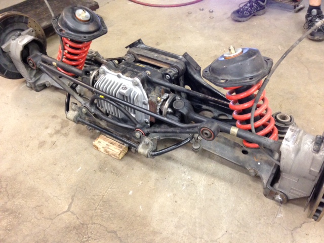

Default Assembly done, going up!
Attached Thumbnails Another Avos Twin-Screw Supercharger Kit in USA-balesdiff7_zpsef4d32e4.jpg   Another Avos Twin-Screw Supercharger Kit in USA-balesdiff8_zpsc8c49a7c.jpg

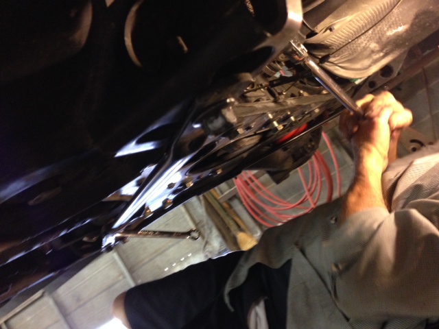

Default Tighten that rascal...
Attached Thumbnails Another Avos Twin-Screw Supercharger Kit in USA-bales101_zpsd2916e97.jpg
