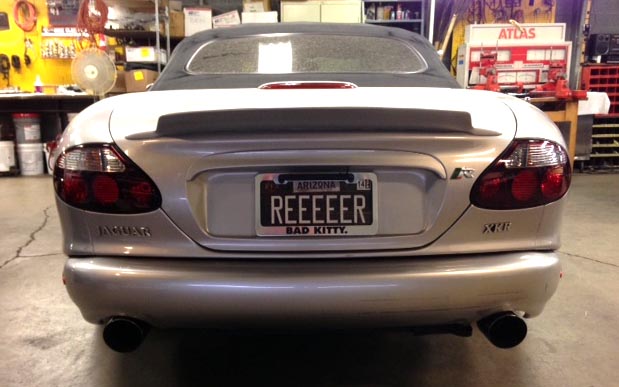

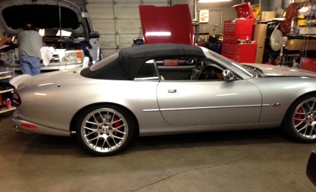

The techs at Falconworks had a heck of a time with the stainless steel braided hoses that were custom made. The hose maker messed up by using the wrong fittings twice and they leaked upon installation. The newest set arrived today. If they don't leak, that will allow Bill to take the car for its first test drive today since the installation of the new lower springs, differential, blue-top solenoids, exhaust system and big brakes.
Polly (Falconworks' office manager) sent me these pictures a few minutes ago.
When they installed the newer Victory tail lamps for me, I had them remove the chrome trim ring from the lenses. I like the way that they look without the chrome trim.
This photo shows how the big brakes look at the rear:
Other views from the side and rear:
I really like how the car looks with its new lowered stance and big red brake calipers. Aw YEAH!

Looks and the power to back it up...what could be better?
Very nice. Love the lowered profile.

Just have to add after seeing the video, how good the lowered effect has enhanced the way the wheels look with the car. They really fit the openings well and look great.
Are they offset as well? Maybe pushed out a little?
Old Sep 6, 2013 | 07:51 PM
  #447
Jeff in Tucson's Avatar
Posts: 878
Likes: 217
From: Tucson, Arizona
Thanks! The wheels use no spacers and are just bolted on.

It got late here and I have an early morning meeting. I finally got to take it for a drive without the fiancee in it. Hah!
The shifts are mind-blowing fast. The handling is like a race car's... VERY flat in corners. OMG. The exhaust sounds bad-***. The rear end HOOKS UP with that new differential. This thing is GLUED to the road.
Thank you to so many that came before me to offer advice and post on this forum about how to do things and what parts to consider. Thank you, Falconworks! Thank you, AVOS!
I feel like I just got a shot of testosterone.
