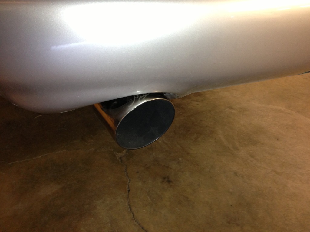

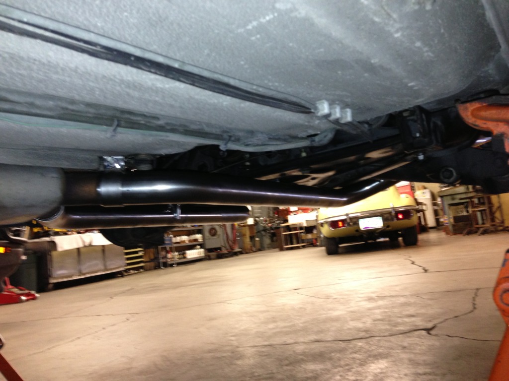

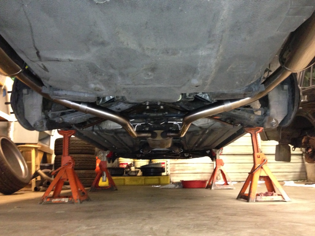

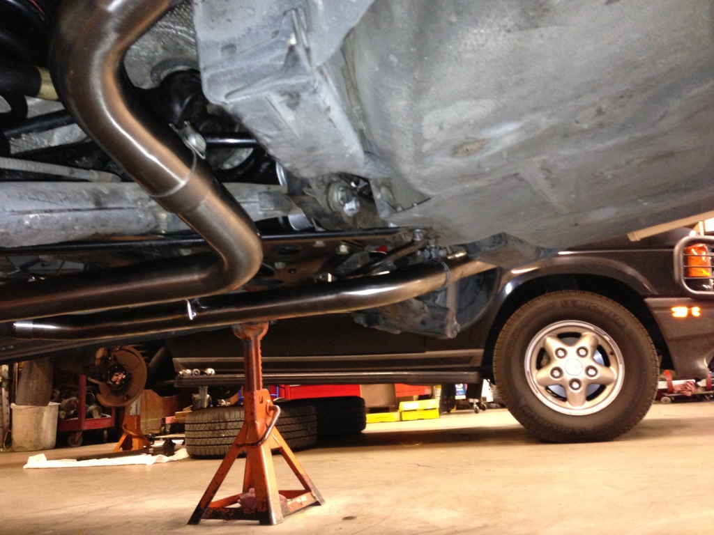

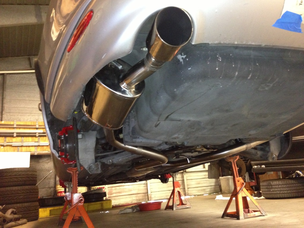

The rear end is now back where it belongs! Measurements have been taken for the brake lines. Those will be available soon. The new Mina exhaust system is pretty nice! The exhaust tips are much more respectable in their new location. The 'low spot' of the exhaust system is in line with the rear wheels, so it won't contribute to on-street issues like going over speed bumps.

Looking very good, Jeff.
Tony (XKRacer) at Paragon Design UK has often recommended a slash-oval type exhaust tip, which follows the existing curve of the lower bumper much better. You might find this to be a cleaner look than the tips you've currently got.
Have a look at post #5 of THIS THREAD and you'll see what he's talking about.

Originally Posted by Jeff in Tucson
Jeff, I would recommend a couple of inch section of heater hose be slid over each cross brace where it contacts the Mina exhaust pipe to prevent vibration from transmitting to the body and prevent wear.

What diameter pipe is used in the Mina exhaust? Is it the same 2" as in the stock system?

I think they are 2 1/4"

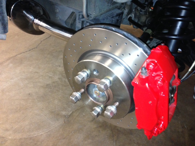

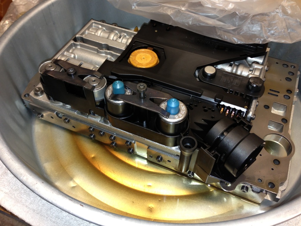

Today I post pics of the Blue-Top solenoids (for quicker shifting), transmission wiring socket (new with new o-rings; it still had the original and they tend to leak if not replaced with new), new custom stainless braided brake lines (improves brake 'feel' and response), and new rear brake rotors. The front rotors are brand new Jag units. The rears are aftermarket. We had to bring in 4 sets of rotors just to find 2 that were in spec. Next time, we'll use Jag brand in the rear, too!
I thank Falconworks Jaguar technicians and owner, Alan, for allowing me to frequently stop by to take photos of the process. These guys are always pleasant!

What brand are the rear rotors? Looking good!
The rears are Eurospare. After finally getting 2 that are in spec., technician, Bill, is quite happy with the result.

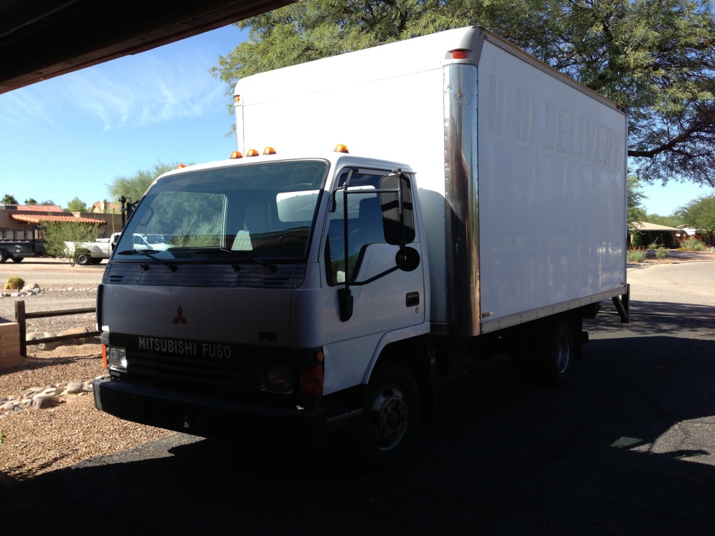

Default My newest ride...
I needed a truck for my business that is bigger than my previous small Toyota truck. There are a lot of these box trucks for sale at great prices right now (bad economy). Instead of driving a rental the entire time during the Jaguar's upgrades, I decided to get this one. I've been driving the danged thing everyday for about 2 weeks now. Nobody has dared to pull out in front of me in traffic or cut me off. Haah!
I figured out how to take a corner faster with it. Come into the corner braking hard, then, in rapid succession, grip and thrust the steering wheel on one side only, over and over again, until the beast has turned, then let go of the wheel as it straightens out exiting the curve. As the hands perform that particular maneuver upon the steering wheel, it looks like there is a lunatic driver inside the cab, trying to imitate the motions of a mouse on a running wheel. Of course, near the apex, I'm off the massive brakes and onto the throttle giving the little turbocharged 4 cylinder diesel everything it's got. All 135 horsepower (280 ft. lb. torque) come to life, going clickety-clickety-click, as it SCREAMS up to 40 mph in about 12 seconds. Aw, YEAH, baby!
Can you not tell that I'm missing driving the XKR?!
Anyway, this box truck has a 16' box and sold to me for $8200. They would have let me make payments of $175 per month, if I had wanted to. If any of you folks in the states have ever had a need for one of these things or can use one to start a business, like landscaping or delivery, NOW is the time to buy one. You can get them a little bit cheaper, but they tend to be quite rough and rusty in the $6500 range. This one has a hide-away lifting gate at the rear, great air conditioning, is rust free, and everything works great. It's a 1994 Mitsubishi Fuso FE with 270,000 miles, rated to carry 12,000 pounds. No commercial driver's license needed. It should be good for another 2-300,000 miles. Since I'll probably only put about 1000 miles on it per year, I'd say that it will last for my needs.
