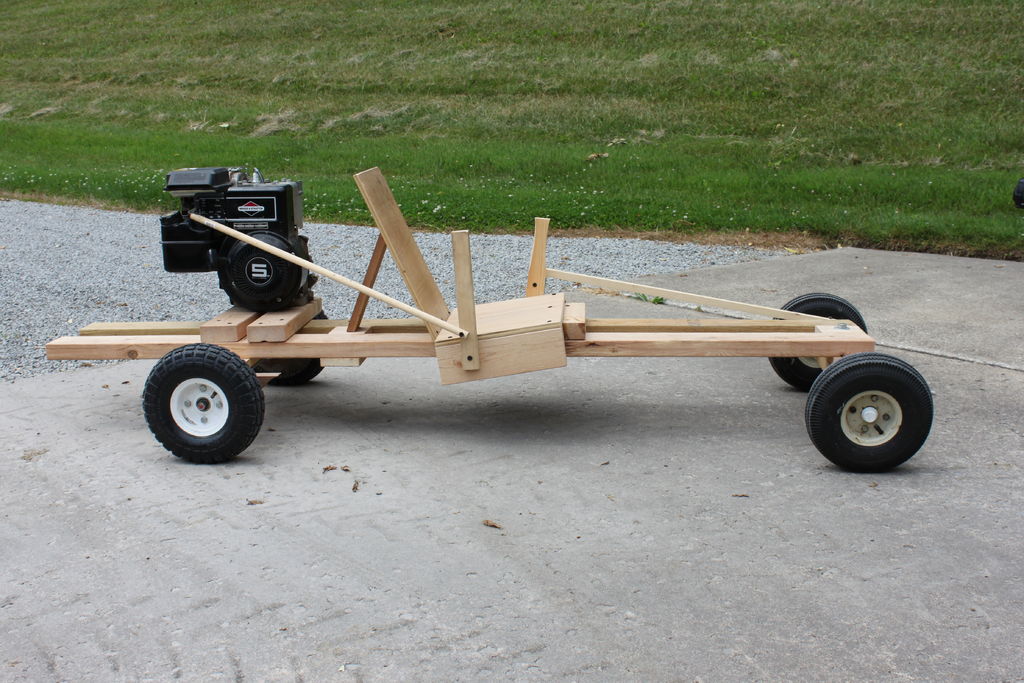

No insult intended to owners of stock Jaguars (seriously!), but what I've created with this monstrously high level of horsepower, without having upgraded the brakes yet, is a bit like throwing a big motor onto a wooden go-kart.
I have been preparing to put on some better brakes. That will be coming!

How did a Camero sneak into this Jaguar forum? :-P

I sent this photo to a buddy, he wants to build 2 so we can go racing.LOL

Silly me - it's not a Camero it's a Morgan
