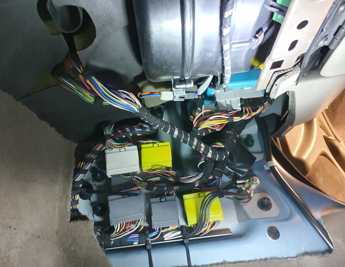

As with many others that have encountered this PIA problem I am now in the midst of the battle. I have read countless threads on this issue but am still at a loss.
1) FOB doesn't lock or open the doors but works with all other functions
2) Key does lock and unlock driver door
3) Manually locking/unlocking with interior handles works on both doors
4) Manually locking the driver's door DOES NOT lock the passenger door
5) Shifting into gear does not lock either door
6) There are no CEL or warning lights showing
Things that have been done:
1) Replaced 10amp fuse in passenger fuse box as it was toast but this, to my dismay, did not resolve the issue
2) Brand new battery
3) Hard reset several times
4) Sprayed WD40 into the lock mechanisms
5) Replaced the door lock relay in the passenger fascia
When sitting in the front seat and pressing the lock button on the fob i notice a slight clicking sound coming from both doors and the area behind the glove box (which I currently have removed). I also hear the same sound when manually locking either door.
Questions:
Can a failed microswitch cause this kind of failure or would a microswitch in both doors have to be faulty? If so, which microswitch(s) could cause this?
Could IDS help to identify the problem?
What else might I look at that could be causing this issue?

I have similar but not exact the same problem. Now I am trying to locate my door lock relay but cant find it.
Removed the carpet on passenger foot well but cant see the relay. Should I remove the glove compartment?
Please guide me

Just a short comment/question in between:
"5) Replaced the door lock relay in the passenger fascia"
When doing so - did you have to remove the glove compartment to access the relay?

My apologies for the delayed response. Yes you have to remove the glove box to access the relay. It's much easier to remove/reinstall the glove box if you remove it like this...

Thanks - I saw the youtube instruction and could not find any fault with the relays.
Next thing is to remove the original, and now wery old alarm backup battery (if fitted)
