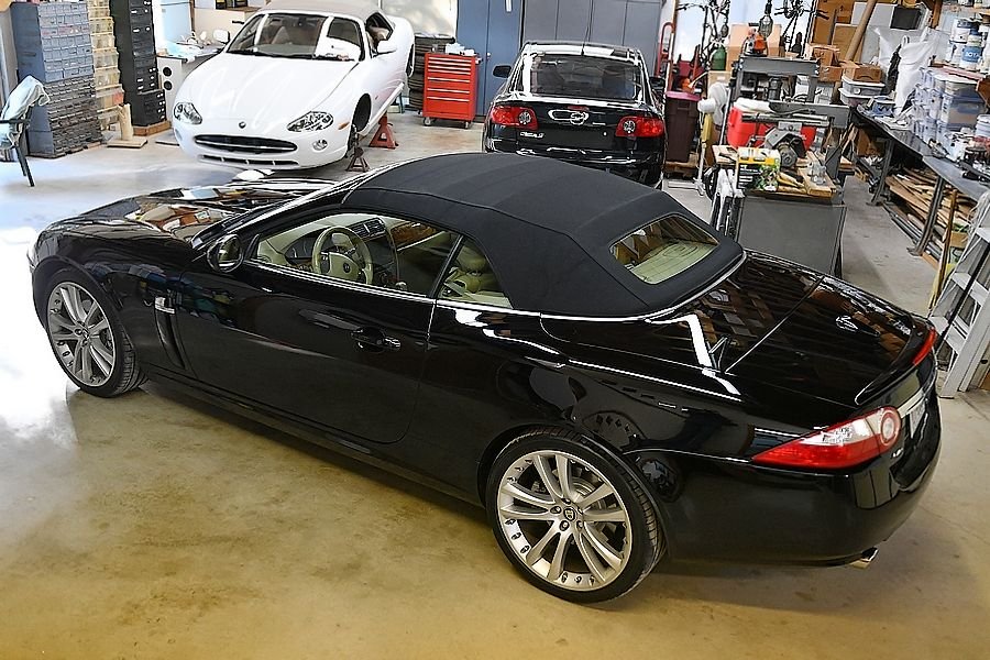

I absolutely love the appearance of the x100 and I also found that almost everybody appreciates it...I have had people get out of their car at an intersection to try to determine what brand it is. It has a universal appeal to many different groups pf people. It is not intimidating but rather enticing. The xk150 is more muscular looking and while still drawing positive comments and thumbs up those tend to come more from males...it is still appreciated by the opposite sex but the interactions are far less.
I love the looks of the x100 and I really, really like the looks of the xk150.
The xk150, imo, is without a doubt a better car all around. Everything is better functionally, looks are subjective, I like the looks of it.
I'm recoloring the leather on the x100 and fixing several leaks at the present, even with the car on jack stands neighbors will walk by the xk150 to admire the white beauty.

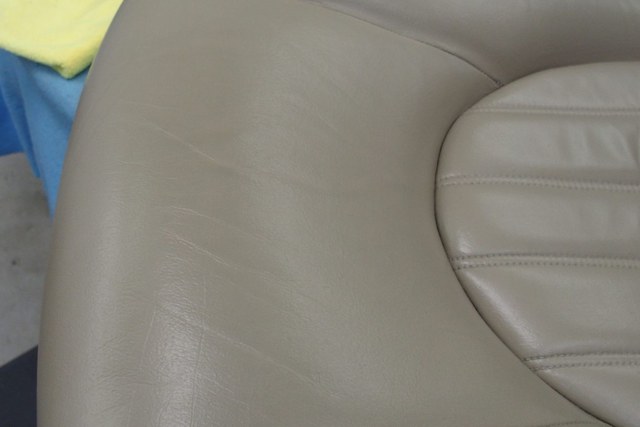

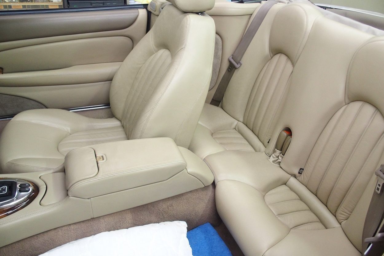

I always refer to Rothwell's excellent thread when I undertake some fixes on my xk8.
I'm quite happy with the coloring/repair of the leather. I used the same vendor as Rothwell for the 'dye'. I redid the rear seat and passenger seat so far. I'll finish up with the drivers seat this weekend and install...then onto the re leak.
(the redish cast is due to shooting under fluorescent lighting...in real life the colors are uniform)

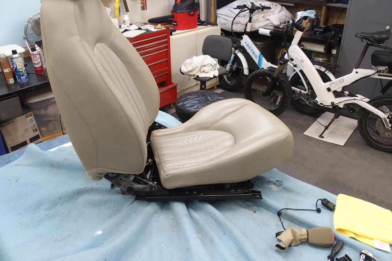

both of my headrests needed repairing, I did that and then tested that they functioned, using a power supply, before buttoning up. As typical some one had already been in there and did a less than professional repair...missing screws, fasteners, etc, etc.
wj
