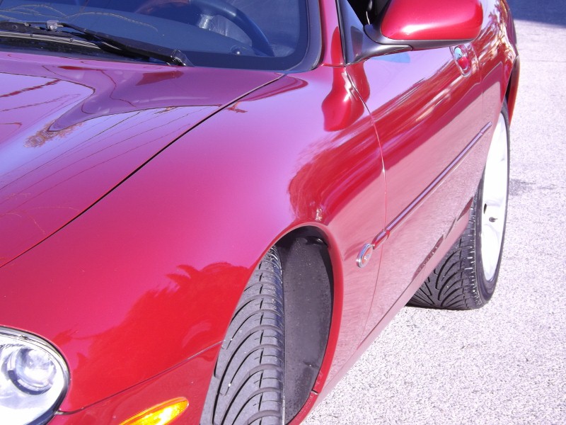

My last couple of XK8 prospects have fallen out various issues.. Today I came across another candidate. Its a clean 2000 XK8 at a reasonable asking price (asking price under $6k).
The negative is high 120k mileage, but car looks very good, and runs perfectly. Recent servicing with replaced coils, new ABS module, fresh hoses, new brakes and good tires.. Convt. top operates perfectly. All windows, seats, steering wheel adjustments etc operate perfectly. Excellent original body and paint condition with no clear coat haze or checking. Transmission is smooth with no lags or clunks. Engine feels strong and sounds great. No hesitation, ticking or odd noises. Seller says he believes tensioners were "probably done" by an earlier owner, but cannot offer proof, so I will need to do an exploration on this at a minimum.
Besides the lack of info on the tensioners, my concern is low front suspension height when measured from center of wheel hub to fender.. I read that spec is about 15.74" and this one measures 14.2".. The packing or gunk at top of shock towers has deteriorated. There is also a bit of jumpiness on rough roads from front end, but it feels stable upon braking.. How big of a job is this to remedy-repair?
The other issue is color, which is a highly subjective issue.. This car is Carnival Red, which is not one of my favorites, but I can deal with it.. However I wonder if Carnival Red is a negative for resale on a downstream basis?

replacing the upper shock mounts is not that bad of a job - recommend replacing bushings, shocks and if necessary the ball joints at the same time.

donfenn - I have recently seen the error of my ways and am now in the mindset as Wayne - several months ago with ~115-120Kmiles I replaced the upper shock mounts, bushings and upper ball joint but left the shocks alone. While doing the repairs, noticed the lower shock bushings were failing but let it go. Now about 15K miles later will be going in to replace the shocks.

My car also is running little over an inch lower up front. Will replacing top mounts get the car closer to stock height?
replacing the shocks (the lower bushing will look like crap when removed ) and mounts and most likely the upper control mounts will be about 600 in parts 200 for the mounts if you rebuild them yourself (very easy and need a pop rivet gun) shocks around 200 (easy) upper bushings around 200 (easy if oem is used and find a like 6 or 8 in bolt to use as a guide for the spacers and bushing on the opposite side of the side your entering from) rent a spring compressor (free from autozone,orielys etc just leave a deposit for the cost of it and its refunded when returned and its time consuming and alot of labor) talking about 8 hrs for both sides

Doing the upper shock mounts are a n/a for a mechanicaly inclined person, and if your so inclined, not to worry, except: If the bolt that holds the upper a frame on is frozen to the bushings or the a-frame housing, you could be in a mess. Look thru this forum for reports on removing this bolt and go from there. Some have even had to cut the bolt and use heat to remove it--takes tools the average guy may not have. Plus ability.

I went back and looked at this one and checked the front end again and its actually only 14" from hub to wheel lip... That's 1.75 inches low.. No doubt that front shocks, bushings and suspension will need the full refurb and update.. So I figure that I have to put about $1000 into the front end. Then there is another $900-1100 for timing chains, if I pull cover and find that they were not done, so even a $6k car could turn out at $8k or more...
So, this car with more than 120k miles could end up being a real investment of $8000 or more...which is market price around here. The fact that I wish it was another color too might make me pass on this....
