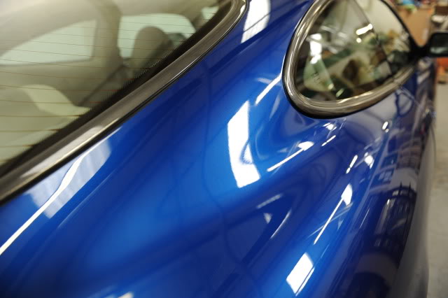

Hi Guys ,
Mine was a bit sticky for years , got fed up of lubing and cleaning every couple of weeks so I bought a complete brand new assembly off Ebay , works fine now but it's still antiquated when most modern cars seem to have the aerial built into the screen or spoiler ,
Nik
