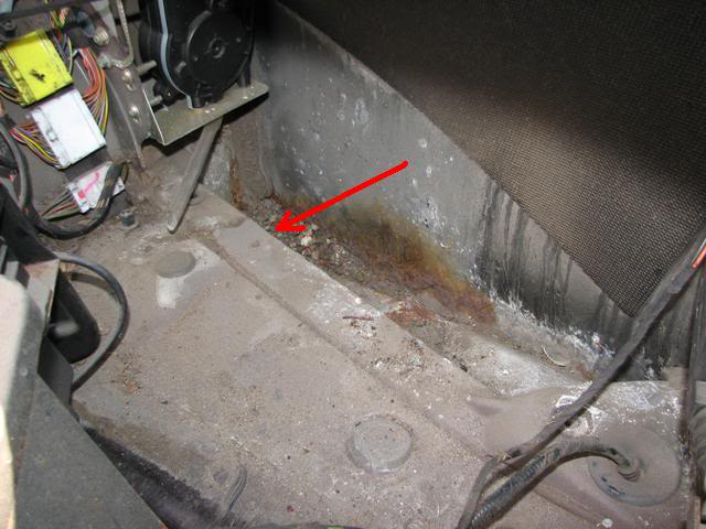

There are a few corrosion areas on XKs that will affect EVERY X100 in time, and all of these points are well documented on the XKEC forum.
The window trim sets bubble under the rubber and the paint flakes off due to poor finishing from factory, there are no longer complete sets available, let alone the price has trippled, assuming you could buy a set they would cost you £1500 ($2250)!
You need to grease your rubber sections with silicone spray to try and prevent water getting between the rubber and aluminium trim, once it does as it is untreated will start to corrode. If it is just the paintwork that is easily fixable.
The floor sections corrode between the floor panel and the strengthening plate, the plate has no use and was only put there for production purposes. I often get XKs with holes big enough to put your fist through, cut them off, waxoyl them up, but they need protecting.
The rear wing just above the rear bumper, inside the boot/trunk area there is a vent, this is there to allow the pressure to escape when closing the lid, these vents are in direct firing line to your rear wheels and in time mud and stones will hold the vents open allowing the well area to fill up with all kinds of garbage which in turn will hold water and your wings will rust from the inside out. This particular rust point is not very well kown as it has taken a long time for it to be noticed, but if you have paint bubbling above the rear bumper I would lay money on it you have a very expensive problem on your hands. Clean the area out and waxoyl it, be careful not to spray the vents.

Front footwells

If you are planning on keep your XK for a long time and you live in an area that has wet, cold weather and particularly if road salt is used, you really need to get your P&J treated.
