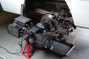

Replacement OE discs on my Brembo brake system are silly money and, although I don't need them changing just yet, I was interested to see on last night's Wheeler Dealer programme that you can refurbish semi-worn discs with a special lathe.
The results on the Porsche Boxster on the tv looked good, but has anyone tried this on their Jag? Cost? Availability?
Attached Thumbnails Anyone had their brake discs/rotors skimmed?-skimming.jpg

In-situ brake rotor turning is nothing new, it's been around since the '80s IIRC. There is no need to turn rotors (on car or off) as a routine part of a brake job.

Wouldn't it make sense to have the discs skimmed when the pads are replaced to get rid of the slight grooving on the discs?

No, typical grooves do no harm. The new pads soon wear themselves to match the contour of the rotors.

According to vendor recommendations the stamped minimum thickness is a "machine-to" number that takes into account the wear from one further set of pads.
In other words, if the machined rotor is at the specified thickness it is safe to use it for one more set of pads by design because there is an allowance included for the wear associated with the newly installed pads.
Second guessing the engineered number only lightens wallets needlessly.

Even above spec, if the rotor has formed hard spots causing brake pulsation, the hard spots may return after machining.
There is also the skill and patience of the machinist to consider. Fast, deep cuts make money faster. Slow, shallow multiple skims produce the best result. Most production shops won't do it that way. You have to be running the lathe yourself or talk the operator into it. If you can get fresh cutters put on for the job .. bonus!
Then, the rotors need to be washed in dish soap and *hot* water. If not, the metal shavings will transfer to the new brake pads and be embedded. Pretty soon, the problems resurface.
When you can get a set of rotors done properly as above, the vehicle can probably be serviced with pad slaps for the rest of its remaining life as long as the pads never get down to nothing.

I am aware that some makers now recommend against maching discs. However, most modern vehicles will usually accept a maching without problem. I will say that I believe it to be a huge mistake to simply "slap a set of pads" onto a used and worn disc. Since I do many brake repairs, I see that "Jaguar" discs, in particular, wear very unevenly. To the naked eye, they look pretty good, but when take to a machine, they sometimes require 3-4 passes on the lathe to clean up. By then, you are either "at minimum" or beyond. If you just change the pads, I would suspect it would take a very, very long time for the two to seat in properly. Might as well buy replacements, which are pretty reasonable in the aftermarket ($100). Brembos are, of course, another story! When they do clean up within specs, I have had very, very few problems with warping and such with normal driving. In fact, the discs on my personal XK8 are resurfaced.

BTW, when I do skim cuts it might take me 4 passes just to get to 360 degree contact on the cutter. I adjust the cutter to just touch on each pass and use the absolute slowest feed I can get on the particular lathe.
