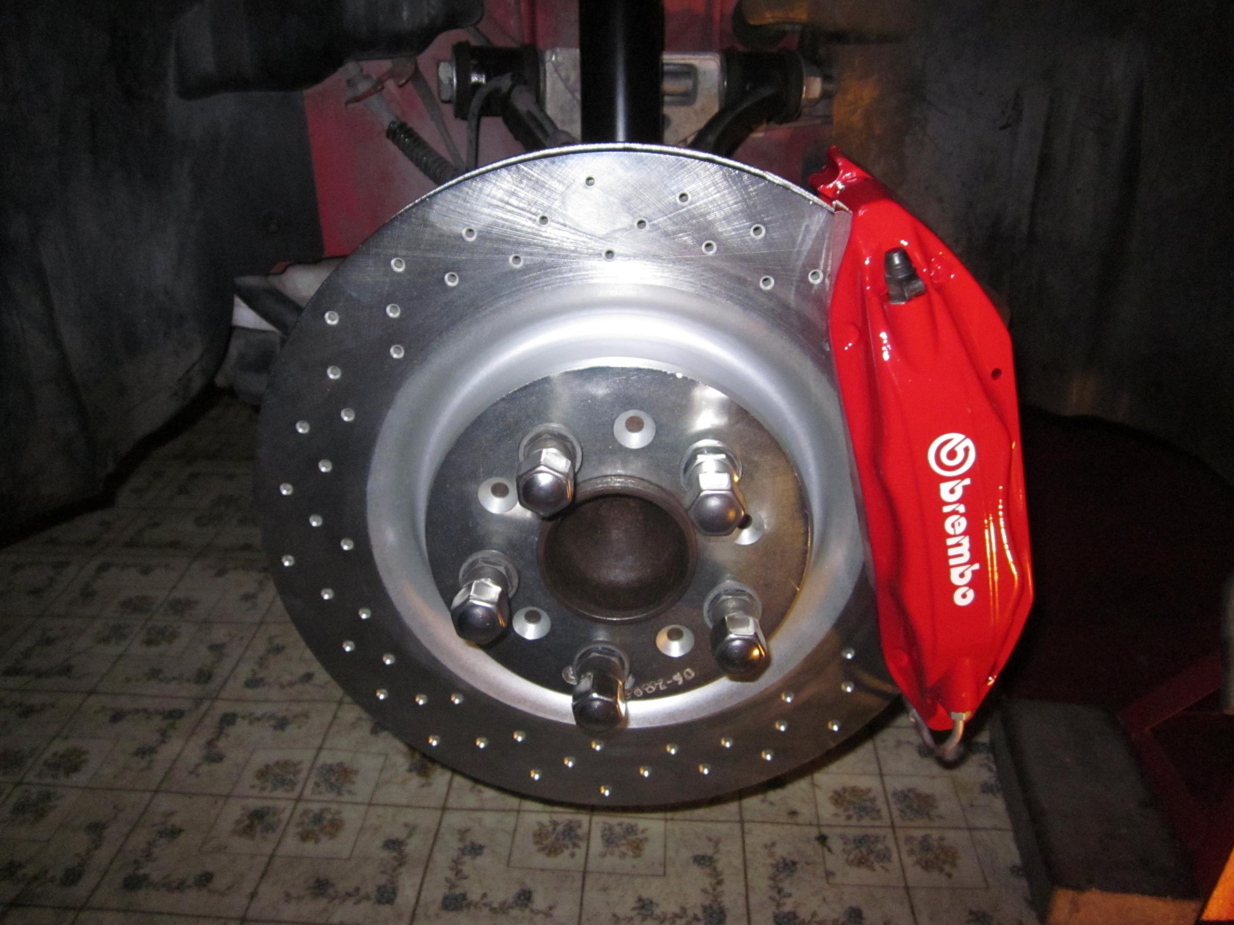

I did Brembos for just over $1000
Used Brembos $450
Brake Performance rotors and pads $457
Goodridge lines $115
The faster you can stop, the faster you can drive!
http://www.ebay.com/itm/Jaguar-Stype...378350&vxp=mtr
