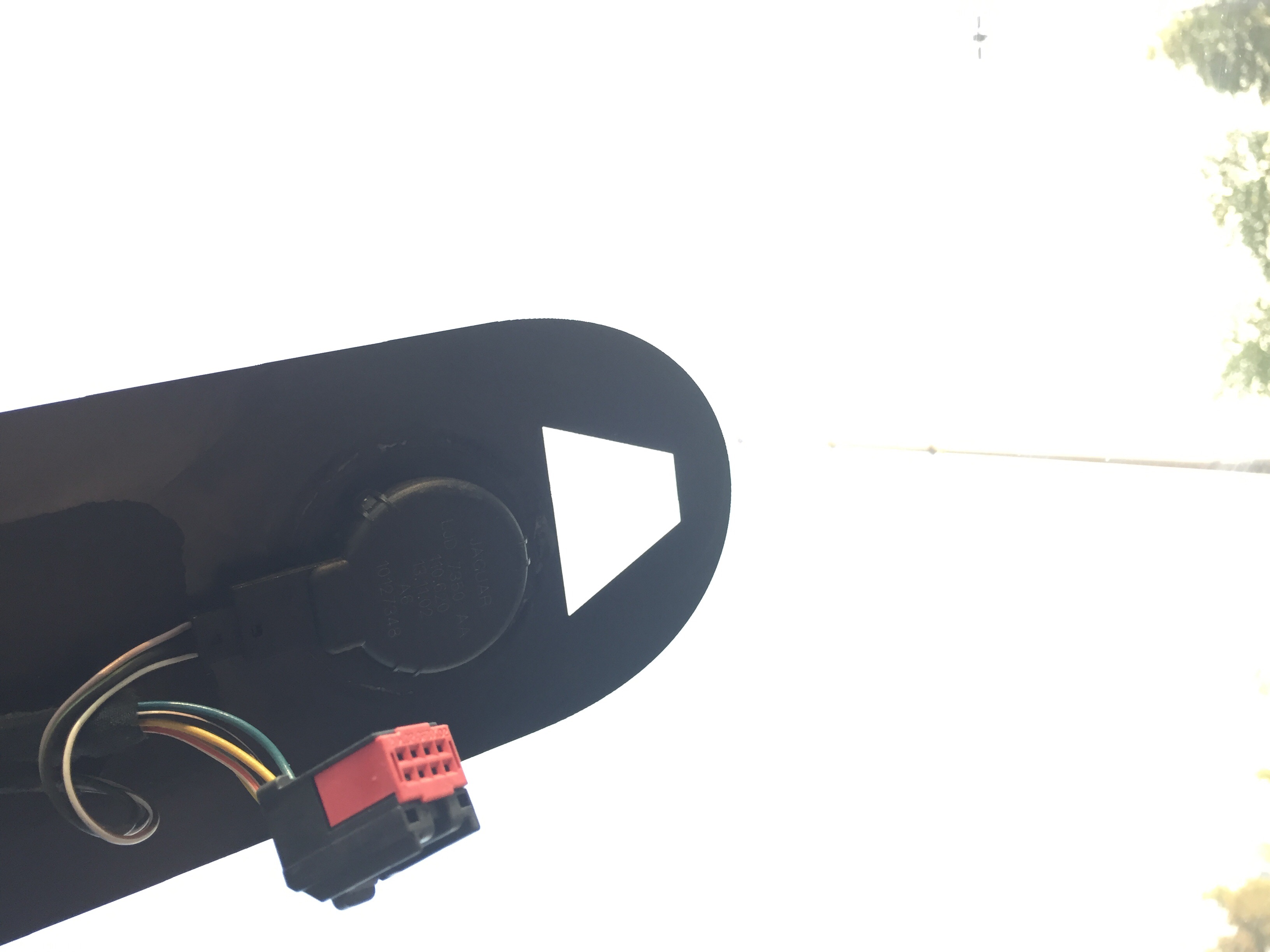

Hello all.
I also have a failing rear view mirror.
Looking for ressources here, I found that most of the issues are fine for the US market, but for Euros like us, it is not so convenient, so I'm looking for solutions, and have some informations to share for Euros like me.
Most of the second hand parts are in the USA, and as soon as you look for a "XK8 mirror", it would cost 150$+shipping.
First problem : I have a 6 plug but 4 wires mirror
Here is the connector mirror side :
Here is the connector windshield side :
Most of the mirrors I find are 3 wires, instead of 4, so what is the wire that has been removed ? And does it cause any compatibility issue ?

Okay, I can confirm that you can repair your mirror for cheap using a 015904 from Peugeot/Citroen, easily findable for a few euros in a breakyard.
BUT the 015904 has NO OTHER compatibility with our 011530 than the mirror (reflective part) in itself.
In fact, any mirror from Magna Donnelly with the same technology will fit, as long as the mirror is the same size.
So yes, a state-of-the-art fix for 30 euros is totally possible and quite easy. Just dismount carefully your mirror, without breaking your cover, and swap the reflective parts.
Just for your information, when leaked, the liquid solder the 2 plastics parts of the cover. Use a saw to dismount the lower part, otherwise you may break the whole plastic case.
But when open, it's easy to operate.

When I looked for a mirror, the only solutions I found where in the USA. Acura is a popular option but absolutly not available in Europe.
But luckily, French car manufacturers also used Acura mirrors here in Europe and are easy to find here, that's the important information.
