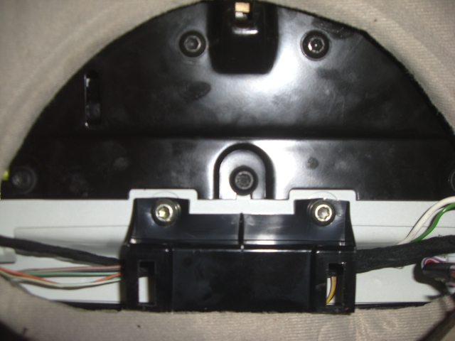

I heard back from Stacy/Sybesma's Electronics. They state they just want the fully assembled mirror. No additional plastics, trim pieces, pins, etc. I have the mirror off the windshield/bracket but I can't figure how to unplug it. The wires (6) go into the mirror itself through the metal ball swivel that fits onto the back of the mirror. There is a retainer clip around the ball that I'm thinking it has to come off.........but I'm afraid of breaking it. Looks to be plastic. Is the plug behind the ball swivel? Am I going the right way here? Missing something? Any help appreciated. I thought the plug was in the windshield bracket assembly.....but it isn't. ??

Default The connector is in the headliner light assy.
The connector is behind this black bracket cover. You can remove the black rectangular metal bracket attached by unfastening the two torqx screws. Below is a picture of the cover.
The mirror bundle had three (3) wires: Black, White and Grey. I think the extra wires are for the rain sensing option which was not installed on my vehicle.

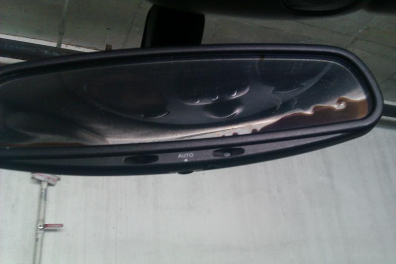

Thank you for the great thread! My mirror just cracked (while it was in the shop for oil change, alignment, and heater hoses)... I'm guessing my shop let her sit out in the direct sunlight and it heated up and cracked!
Sounds like I need to make a call and get a little cheap temporary solution while the mirror is repaired!
Thanks!
Keely
Edit: I went to the garage... and the mirror is leaking! You can see the brown swirls on the mirror in the pic, and below and to the right of the "auto" you can just barely see where the toxic goo is melting through the plastic! EEK!
Edit2: Got the mirror back and it looks fabulous and works great! Thanks again everyone for this awesome info! I got an Amico Rectangle Car Rear Vision Mirror with Suction Cup off of Amazon as a temporary - and being less than 10 bucks, I got what I paid for. It wasn't a terrible temporary solution, but I was very happy once my mirror came back and I was able to SEE again! The absolutely worst part about not having my mirror - remembering to turn my headlights on and off!
