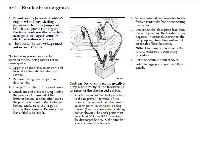

For those who see the thread title and don't want to wade through a 32 minute video, the Driver's Handbook gives the essential information on emergency starting:
Posted here because a lot get it wrong BEFORE looking for the correct way to do it.
