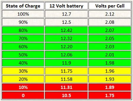

Originally Posted by Wag
Ive got the message up again today but I'm reading 13.8 v with everything on , 11.8 with engine off.
11.8 with the engine off is too low, especially if the battery is charged overnight on a 2 amps.
The alternator could be intermittently bad, but the battery should be 12.5V or higher if its in good shape. Below 12.5v, a lead acid battery's power goes down quickly and accessory load can drag the voltage down low enough to throw a light.
A proper AGM battery showing 12.0 volts at rest only has 45% of the charge of a new, fully charged battery and is low as you'd ever want to repeatedly take down an AGM battery. (11.80 is 30% and is in the Battery damage range)
