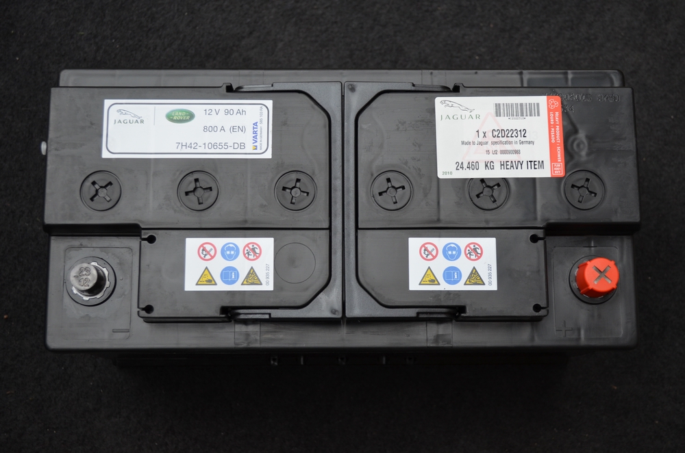

I've had my CTEK XS7000 for approaching five years now and have used the Recondition function without any problems. I did follow the instructions to first disconnect the battery and, as an extra precaution, reconditioned it off the car.
An OE battery in Europe spec vehicles will be Varta brand. You can tell the manufacturing date from the code on the negative terminal:
This one is 23/12 meaning manufactured in Week 23 in Year 2012.
Attached Thumbnails Battery reconditioning - is it safe?-11-new-battery-unpacked.jpg
