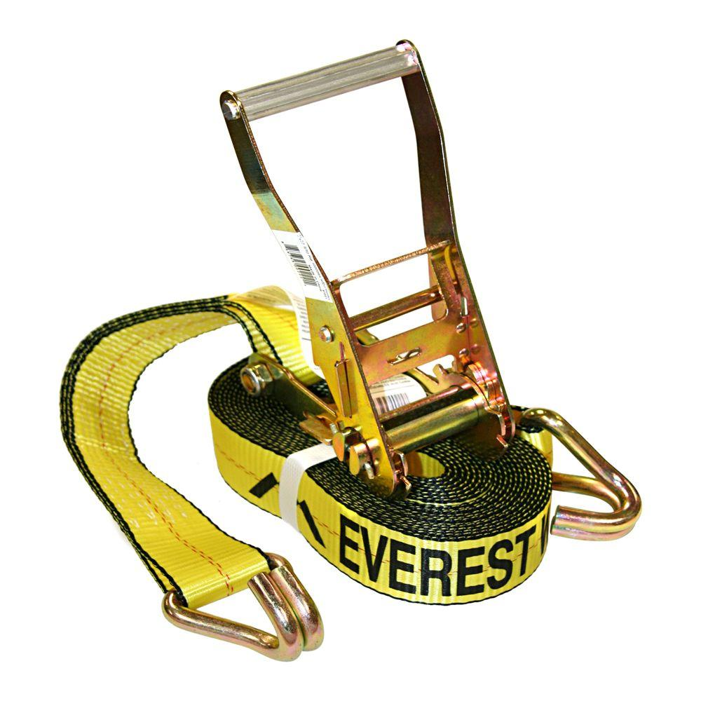

No vent holes on the battery? Or no vent tube provided by the owner?
And handles for your cocoon are available at Home Depot. See below. I'd use two hands.
