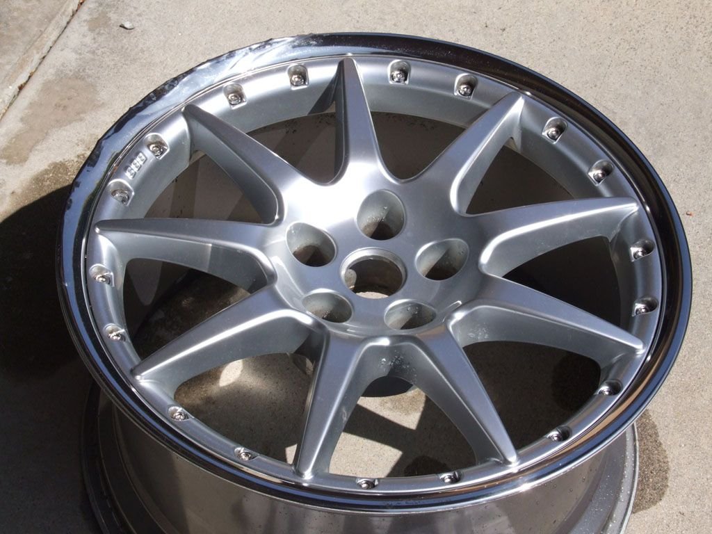

My 2003 XKR has Montreal 20 inch BBs wheels and I have not been able to find anyone tor replace a bent trim ring. Does anyone have suggestions as to where I can get it repaired?
Had a similar problem on my 2002 XK8; My tire dealer here in Monroe, La. sent me to a company he recommended, and this guy - obviously had years of experience: Done in 2 hours, for $100, & you can't tell where the bend was
from the unseen pothole....absolutely no vibration from the new Pirelli P Zero tires...Sudrely you can find such a service in N.J.

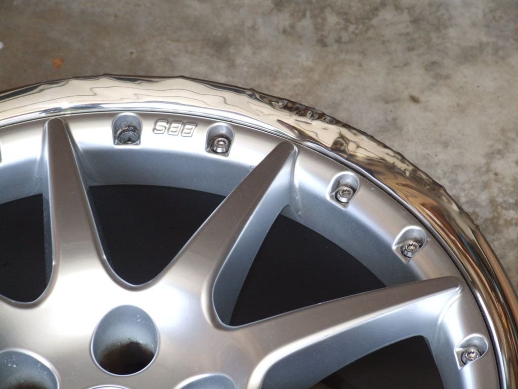

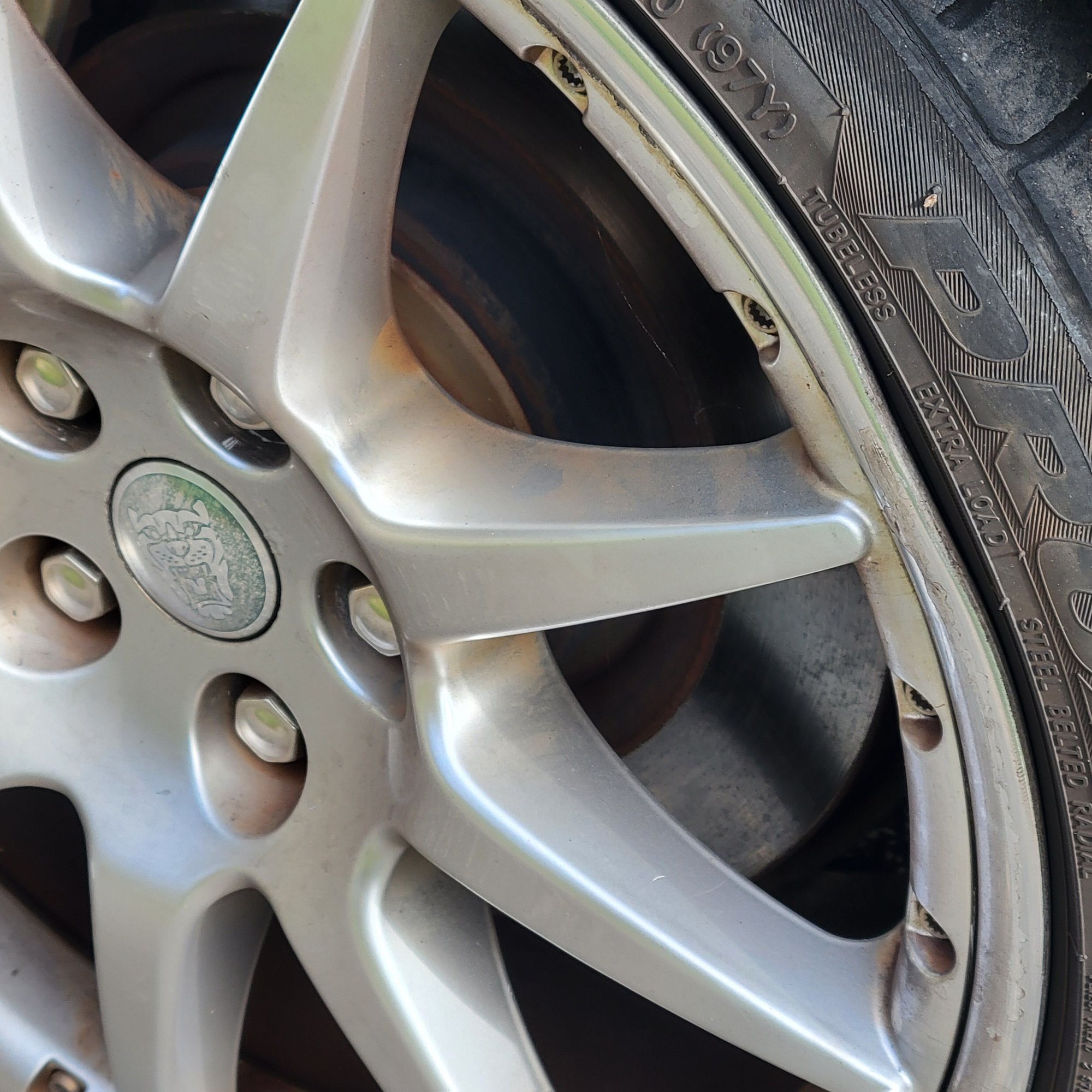

Tmattson57
Cant get my head around what the shop did to your wheel! The photo shows 2 valve caps! And the lower RH 90 degree segment only has one bolt, the hollow valve stem bolt. I would say they are unsafe.
Old Nov 11, 2021 | 04:01 PM
bcprice36's Avatar
Joined: Feb 2017
Posts: 2,089
Likes: 923
From: Houston,TX
tmatteson57,

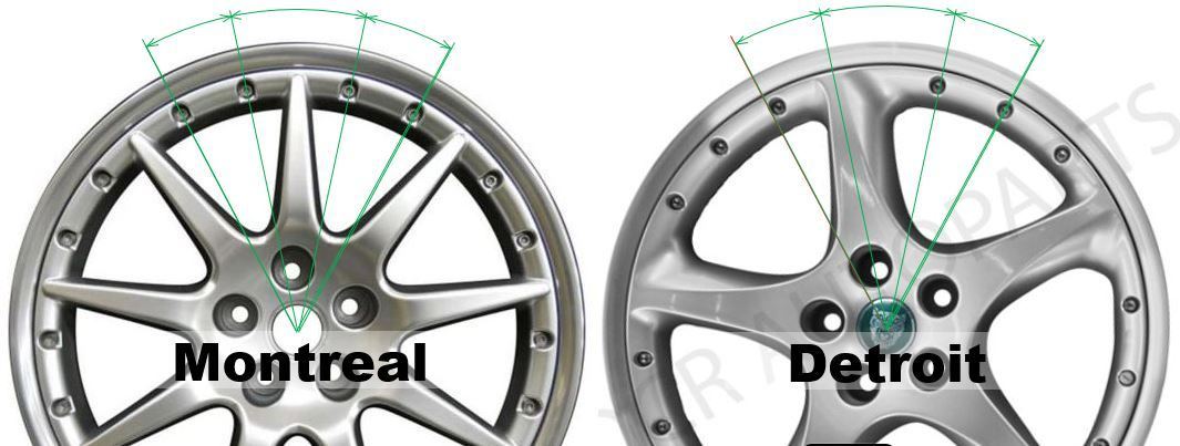

Whoever put the Face (Detroit) part on the Wheel has it in the wrong place.... the "Air Stem" HOLE should be on the "S" side of the BBS and it is not! That's why the Bolt Holes are not lining up! You need to take the Wheel off and remove the Face Plate....Then line up the Air Valve Hole with the wheel (Barrel)...Then the Holes should line-up correctly.....Then you need to replace all the Bolts with new ones...Be sure to use the proper sealant on the Bolt Threads before putting them back in.....
Do not Powder Coat your Wheels....They are made to paint.....Just spray them Silver then if you need to....You can repaint them and they will look like new...
Your Wheel is not set-up correctly, so don't drive too fast until you get it sorted out! Get the parts you need from SB Wheels in England or Coventry West in
Atlanta....I would get all new Bolts and a new Air Valve and Screw also a Tube of "Bolt Sealer"!!!! Also check out the alignment of the other Detroit Wheels and see if they have all their screws and if they are properly placed with the Air Hole.....Whoever did this didn't have all his
Ducks in a row!

Thanks BC...I also discovered that what appeared to be caps arereally another type of bolt they used because the beginning threads are gone and the 'replacement bolt' is longer then the normal bolt. Along with this issue the other 'missing bolts' from the other wheels are in fact broken off.

So the mystery unravels...it appears the previous owner mated a different barrel (he thinks it was from a Montreal) to the Detroit face because that was the only thing available to him. He claims he has been driving on it with no issues for over a year. I also checked the other wheels and all of the air valve positions are on the 'B' side of the BBS. It just keeps getting better and better.

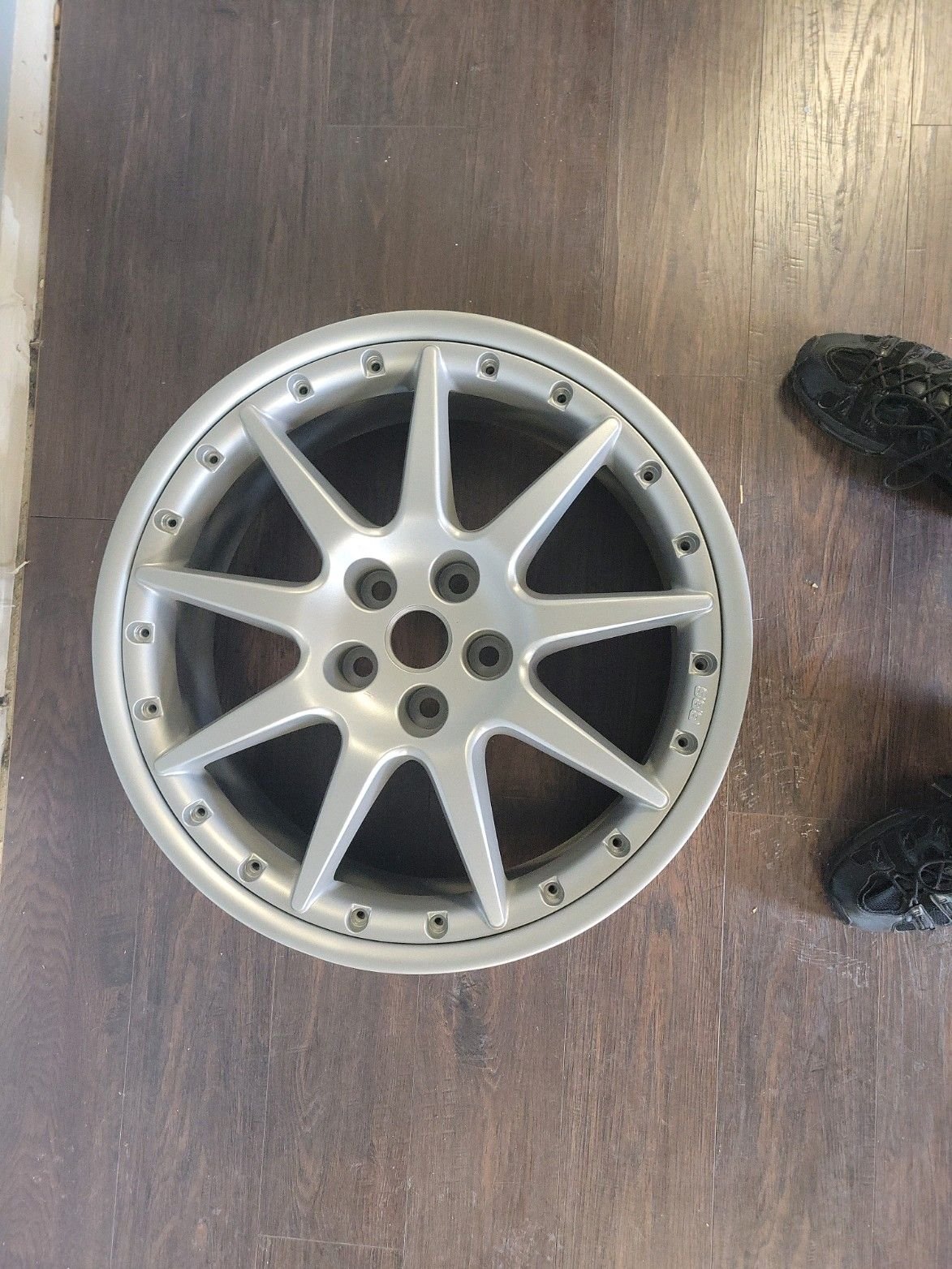

Default Wheel repaired
Got the wheel repaired and powdercoated all 4. New bolts as well. Cost 745.00 and they look fantastic!

tmattson57,
Thanks for highlighting this issue. It's not immediately obvious that the spoke face bolt pattern differs from each BBS wheel model meaning they are not all interchangeable. I do wonder how you solved this issue?

Before
After

Originally Posted by daniellalli
Before
After
It the "after" photo reflective of removing the ring entirely or was a new ring installed?

From: new jersey
Ring was repaired and center taken off and repainted
So in your photo there is actually a ring on the wheel but it has been powder coated along with the rest of the wheel since it clearly doesn't look chrome? Unless there is some technique I am not aware of I think my ring is too far gone to straighten/flatten so my only option would be another new ring or remove the ring. But both options would require disassembly of the wheel I suppose.
