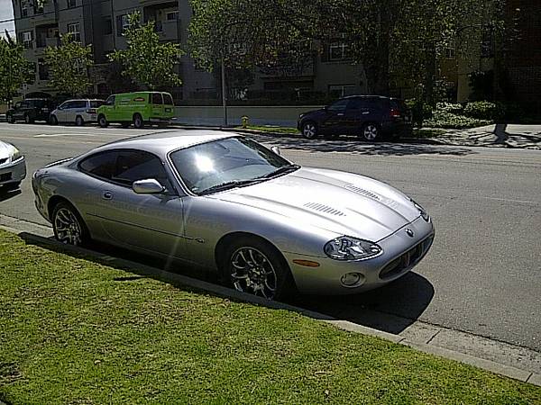

I found these 3 local cars for sale (click on the title links for more info):
1. 2005 Jaguar XK8 Conv 53k mi - $19,995
2. 2001 Jaguar XKR Conv 179k mi - $7900
3. 2002 JAGUAR XKR Coupe 92k mi - $11500
Which one would you guys pick? Is 179k mi too high for car #2? I personally like car #3 the best. What is the reliability of 02MY vs 05MY (with the latter's 900+ new parts)?

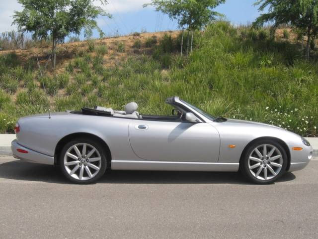

You don't give a lot of info about #1 and #3, but if money is not an issue, I would go for #1 since it would have most fixes for earlier problems. (Old Ford philosophy - best Fords are the last models!) If you prefer a coupe, then #3 would be your choice. I am not a big fan of chrome wheels.. Just my 2c

All things being close to equal, I'd go with #3 hands down. If I could find a XKR for that price, I'd be all over it.

I don't know the mileage on 1 & 3, but for the price difference and since you like #3 that would be my choice. 3 a XKR, a coupe no green showers, has the Merc transmission, which is practically bullet proof, the Nikasil engine problem have been addressed, The only thing depending on the build date would be the secondary tensioners, and if it's a later date it would have the newer metal tensioners. For $8500.00 difference you can buy another toy. 179,000 is pretty high mileage for # 2 the price reflects that. There was 900 engineering changes on the later models not all were for improvements many were cost cutting. Prime example going with the ZF6 speed trans. for both XK8's and R's one supply source. The later 4.2 motor does have many tech. improvements over the 4.0.

Probably would recommend #1 for all the reasons given already. Plus it's a convertible and you live in LA. Price is a little high, but not overly so.
Having said that, I personally like #3 better. It's a coupe, it's reasonably priced for years and miles and it's the R-model. There are some issues with 2002 MY, but it didn't take gobs of money to get my 2001 running without issue. I would have no fear of a 2002 as long as it checked out OK.
The later models did fix a lot of the mechanical issues (tensioners, 4.2L, etc.), but traded them for electrical gremlins.

Unless you particularly want the rarity of a Coupe in CA, the 2005 is the one to go for.

No question for me. It's #1. It sounds like the 2005 BRG XK8 Convertible I bought on New Year's Eve just 4 1/2 years ago. The mileage was 27,700, and the price was $27,300. My mileage is now about 66,500. Other than a "new intake bellows" and a new set of tires, I have had a lot of fun and no problems. Every time I look at it, I say to myself "What a beautiful car!"

I vote for #1. Hey, I like the color! Let's face it you're in Socal---I can see you now just cruising down Pacific Coast Hwy. with a big grin.

Agreed, you need to decide if you want to have a coupe or a convertible. Or you're like me and you can't decide and wait for the right one to come around and will maybe try the other flavor later on. If funds are no option, and since you live in CA, #1. But the best overall value is #3. And with #3, if you replaced the chrome wheels with silver Sepangs... oh man... that is my favorite X100 flavor right there.
