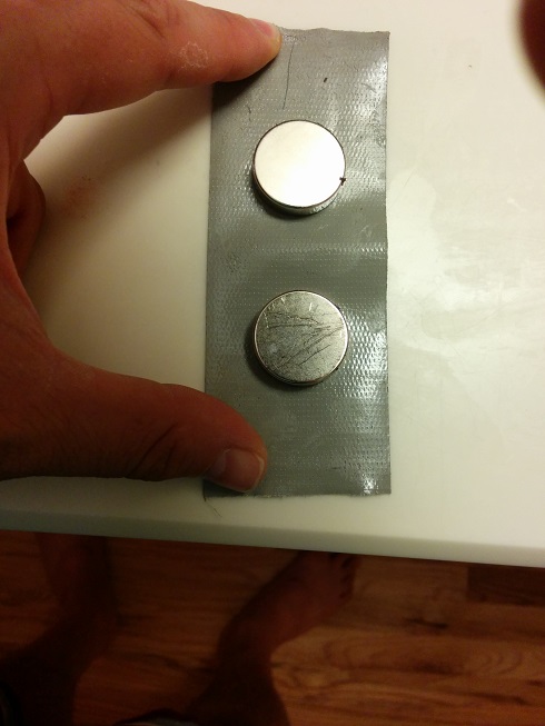

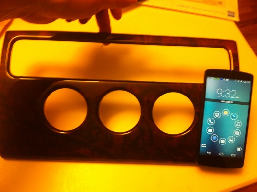

So I had an idea and it seems to work really well. I hated all the cell phone holders I had so here is what I did. My phone comes with a metal back, if yours doesn't it is easy to put in. You can put something between the phone and the case or in the battery compartment.
Anyway I purchased 2 rare earth magnets, they are real cheap. I put them on a piece of gorilla tape and then put them behind my dash. My phone now attaches to the dash without any visible holder at all. It works great! 5 minutes and $11.

Neat, I'm surprised they hold thru the metal backing behind the veneer. Good idea, be sure not to scratch the wood finish!

quick update. The gorilla tape did not hold so I used a drop of super glue along with the tape. Hopefully this will hold.
The concept is working great.

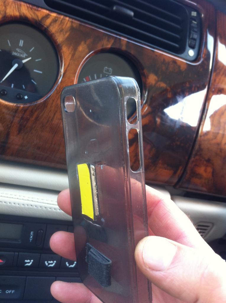

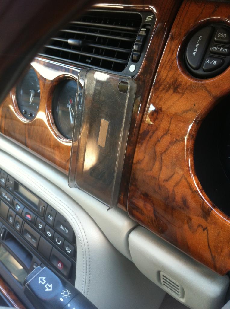

I have done this but stuck the magnet to a phone case. Then i clip my phone into it when i get in the car. I love the uncluttered look
