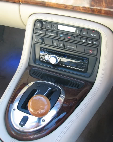

Not sure if it is the same but I installed a JVC DAB (digital) radio today. We replaced all the speakers (Alpine G series, fitted an amp (Alpine), a sub (JL Audio), all the goodies.
Cost the customer £1000 ($1500) but this included a custom made surround for the head unit so it didn't look too after market. I have the pics at work, can post up tomorrow if you like.
