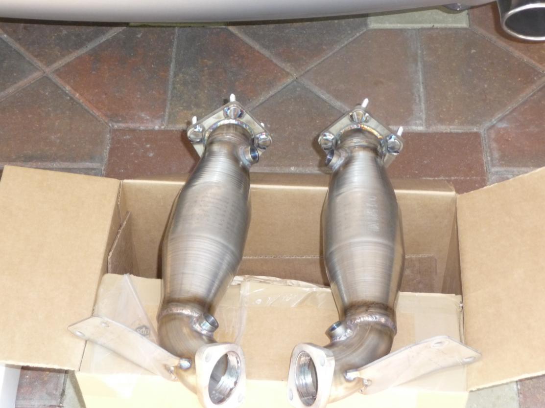

Hi guys,
I opted for Jason's 200 Cell High Flow Cats from Nameless Performance, and they are due to arrive today! I plan to post pictures later this evening, and hope to have them installed within the next several days. Jason was kind enough (and had enough belief in his product) to offer to pay for my Dyno Runs, so as to gather real data for all of us to digest. As he will soon have Dyno Info on both his 200 Cell Cats, and Downpipes, he will not be paying for any more Dyno Runs. This really was a very magnanimous offer by Nameless Performance, and I appreciate it greatly! I have an appointment for my first Dyno Run this afternoon, so I had better check my air pressure.

Thanks guys, I'll try to keep everything as similar as possible and definitely let the ECU reset. I got lucky and flagged the UPS Man down to get my Cats delivered early. They were packaged securely, and appear to be extremely well manufactured! I am by no means an expert, but they look GREAT to me!
Here are the pics. I'm off to the Shop for my initial Dyno shortly.
Brian
Attached Thumbnails BIG Day today:  New Cats arrive and first Dyno!-p1020473.jpg   BIG Day today:  New Cats arrive and first Dyno!-p1020469.jpg   BIG Day today:  New Cats arrive and first Dyno!-p1020475.jpg

OK, the new Cats are in! The Tech was again most impressed by the SS construction and overall build quality, and the fit was perfect! As Jason had expected, there were no CEL or warnings of any type, which makes me very happy. The new Cats sound absolutely fantastic! Are they more aggressive? Hell yes! Are they obnoxious or over the top? Not to me, I definitely like the sound! The Jag has more of a pronounced SNARL now, bringing to mind that of a well tuned Euro Sports Car. Acceleration "felt" quicker and smoother, but I know that is quite subjective, so I'm interested in seeing the follow up Dyno Stats deciphered by more knowledgeable parties. In any case, I am very happy with the new Cats, and have no regrets there.
It was unseasonably cool today, so I am waiting for identical hot weather for my second set of Dyno Runs. This will also give the ECU the opportunity to reset. They are putting a CD Rom on their computer so as to be able to give me all the info in electronic form, rather than just a printout.

Hi guys,
Thanks for the good feedback on the AF Ratios. I'll have the mechanic look into that after I take my second Dyno Runs. I want the circumstances to be as exact as possible, so no tinkering yet. Just a thought, would the AF Ratios show up in a "Scan"? I do have a Scanner, so I'll scan it here shortly. I recently went through a nightmare of trying to hunt down persistent P0171 and P0174 Codes, so I really hope that the old problem is still not lurking in the background. (I just did a scan, and nothing showed up. Maybe they are not far enough out of whack?) I need to learn how to better utilize the Scanner's capacity for showing operational info. So far, I have just used it to check for the reappearance of those problem codes.
It's a shame that the Cats are so well hidden, as they are definitely an Artful improvement, as well as Functional. I can't wait to drive it today and listen to the exhaust music!
