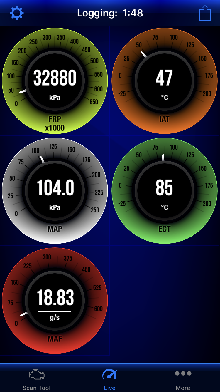

Note: Only the Excel Report is from my XKR. The Graph and Gauge view are from my Range Rover Sport - data displayed does not apply to the XKR.

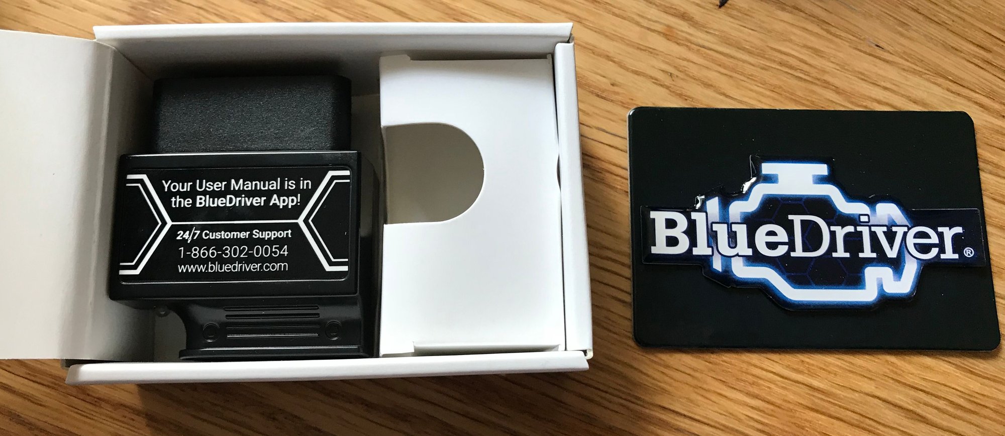

Box as it arrived

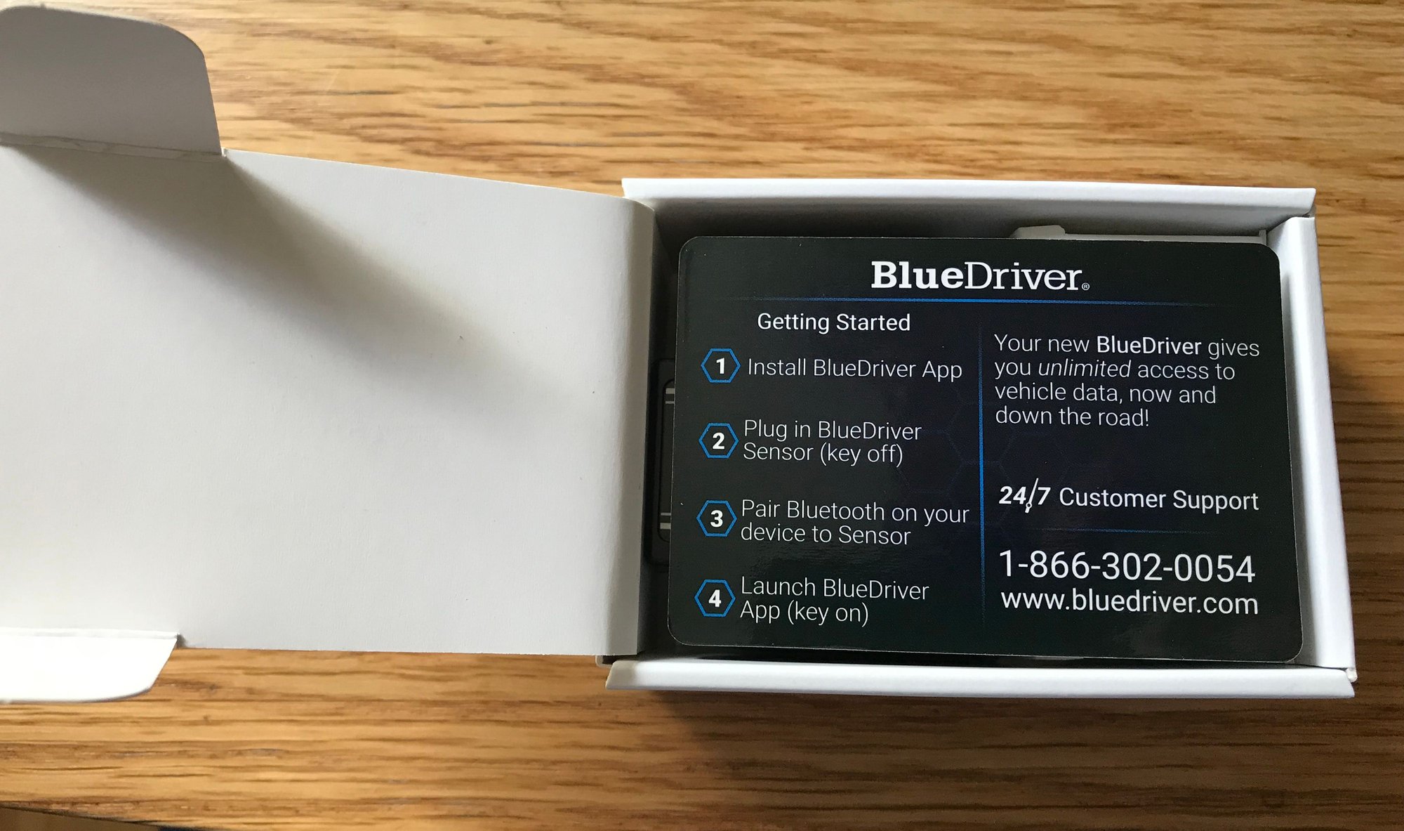

Installation Instructions
Scanner and some silly decal

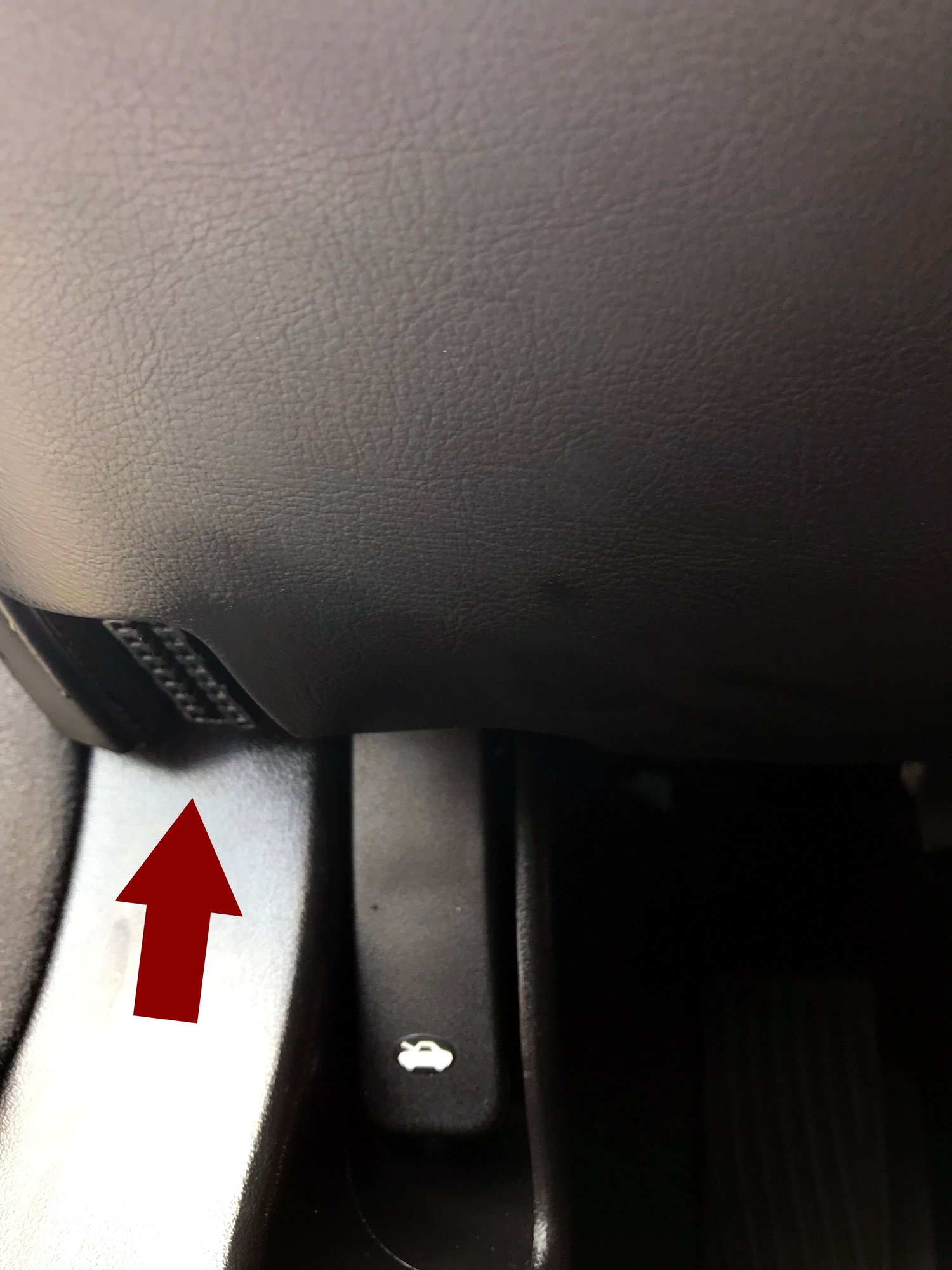

Here is where to plug it in.

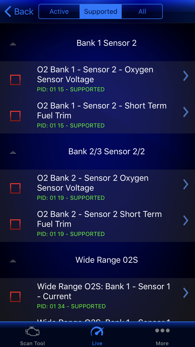

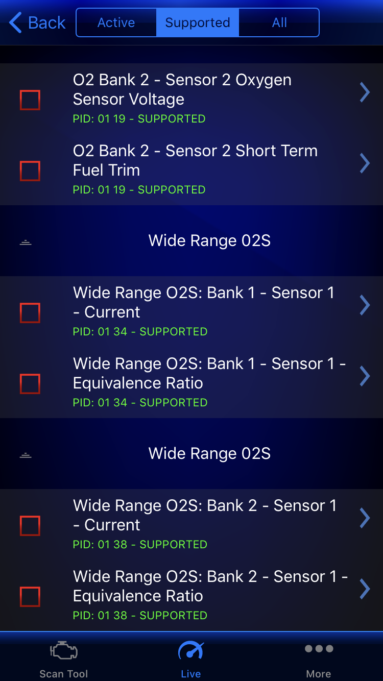

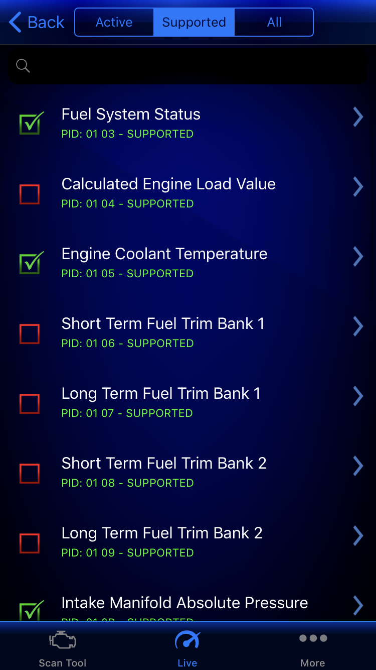

What my car allows to track 1

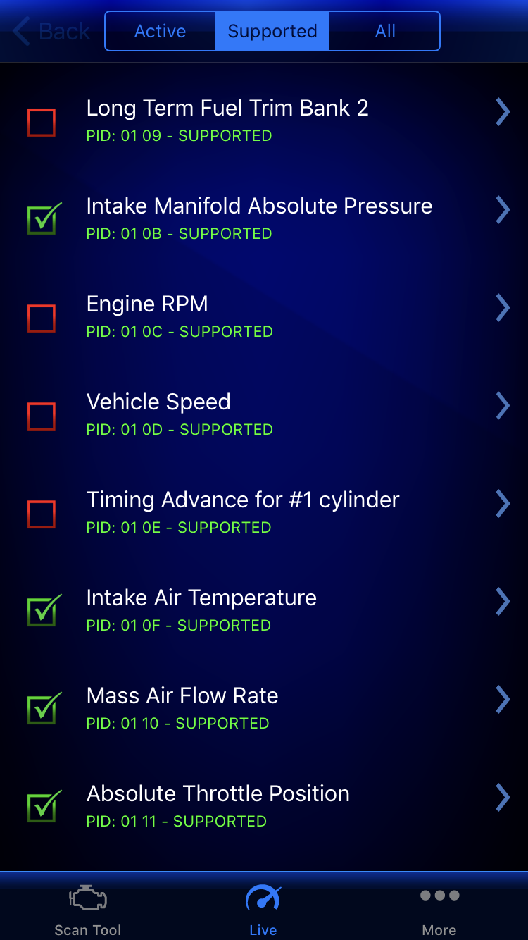

What my car allows to track 2
What my car allows to track 3
What my car allows to track 4

Gauge View in Live Mode

According to BlueDriver the codes available for tracking are determined by the car. Would you agree on that?
I wonder, as I read quite often in the forum that one should check Fuel Pressure, which is theoretically available on the app but not supported by my 2002 XKR. Strange.

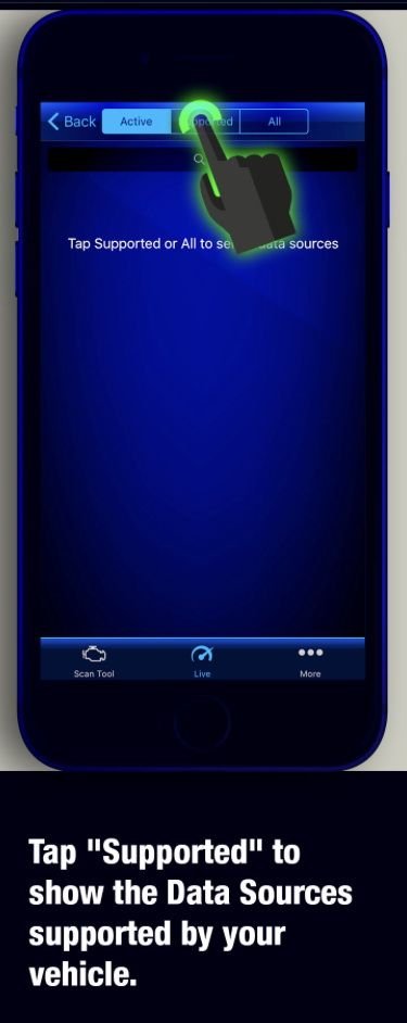

The OBD2 Scan App features a big list of data sources/parameters/metrics that can be checked/tracked/measured.
However, not ALL parameters can be actively accessed - thatīs why the app has a tab for "ALL" and one for "Supported" data sources.
Which data is available and which is not is due to the car - thatīs what the makers of the app / sensor claim, and thatīs what I wanted to get confirmed or discarded by some of our forumites.
Background to my question is, that "Fuel Pressure" is not supported by my car OR by my sensor/app and I have read "measure your Fuel Pressure with an OBD2 Scanner" quite often in our forums (and Iīm a bit disappointed, that I canīt).
Hope my question is a bit more clear now?

Aha, thanks. Yes, part of the OBD II spec is a number of PIDs (ways of asking the car something and getting an answer) which say what other PIDs are available. So, for each of the PIDs which might be supported you can find out (on any OBD II car) whether that PID actually is supported.
(By way of example, it makes no sense to support some PIDs on a diesel car that would make sense on a petrol (gasoline) car.)
If your car has a fuel pressure sensor (I expect it has) then a PID to read it is highly likely to be there.
Sadly, some tools fail to report things that are available! (Software bugs are all too common - e.g. Windows.)
Worst case you can probably put an actual pressure gauge on the fuel lines (often a Schraeder valve.)

To my knowledge, Fuel Pressure is only available over OBDII on the later 4.2 return-less fuel systems. The earlier systems are more conventional, with a basic fuel pressure regulator.

Again, very valuable input from you.
That explains, why I canīt measure it.
Very good to know!

If you are willing to work the logic a bit, it is explained here: OBDII PIDs Mode 1
Basically, you can ask OBDII for these specific codes, and the answer can be decoded in software to find out what other (standard) codes your car actually actively supports. It is based on ranges, so it scales up nicely. It is sort of a discovery protocol, or a "meta" code, if you will.
