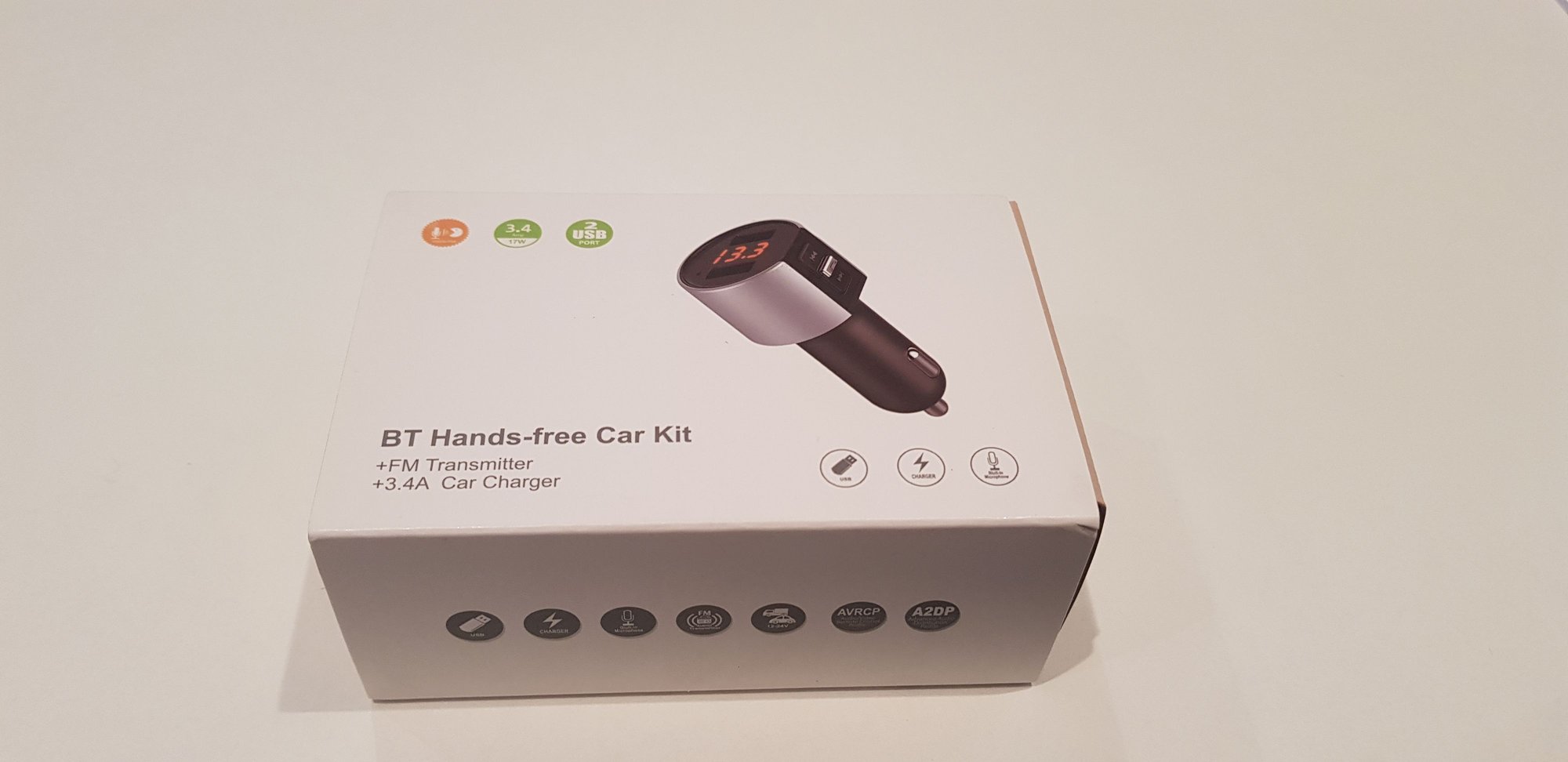

My transmitter just arrived through the post, will try it before ordering the BT45. My plan is still to install a smartphone to replace the old satnav. Also ordered a low-profile ODB2 so will use that with TorquePro to give pretty readouts on the new smartphone dash. That, Google Maps and a music app should do the job, though I am tempted to try and get RealDash working. If the ODB2 works fine with the XK8 and Torque I will post price and details here.
Phillip.
