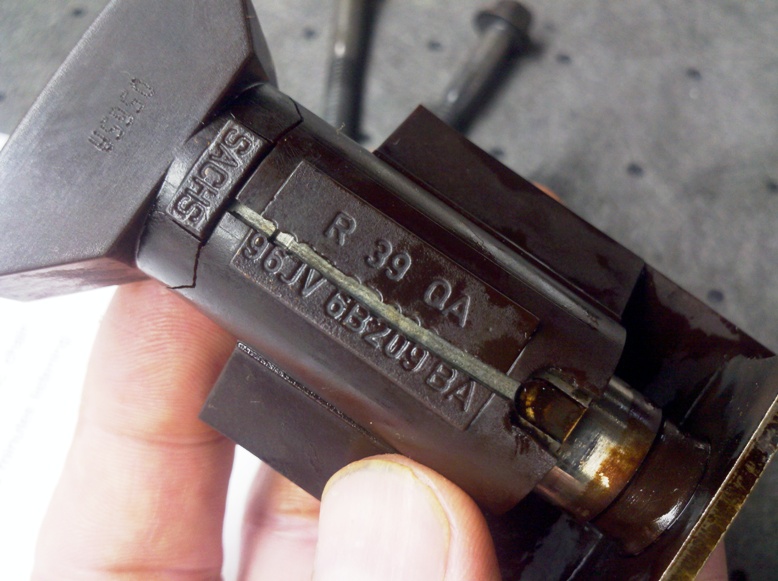

Quick background: bought my 1997 Coupe in early June, from a local dealer (it was a trade-in). Spoke to the doctor who owned the car for 9 years, and he told me the tensioners had been changed to 2nd generation plastic type many years ago. So I knew that I needed to update to 3rd generation metal tensioners, but it wasn't a code-red emergency. No rattles on startup, and I wanted to familiarize myself with the car a bit before jumping in.
Fast forward: Last week, I had my RH valve cover off, investigating another issue (to be posted later). While the cover was off, there it was, my 2nd gen plastic tensioner, mocking me. I decided to buck up and get it done. Studied up on the tensioner change methods on this forum, ordered the parts, and got started.
On the RH side, the 2nd gen tensioner was cracked, as typical for this type. But it was still holding on.
Popped off the LH cover next, and was quite HORRIFIED to see a 1st generation plastic tensioner still in place...with 111,000 miles on it! One plastic shoe was completely gone, with the chain rubbing across metal (but no chain damage yet). The other shoe had a big chunk missing, and the tensioner body was cracked from top to bottom. Horror show images below.
There were no broken pieces to be found nearby, so I dropped the oil pan. Nothing much to see in the pan...because nearly all of the plastic bits were caught in the oil pick-up screen. It's a fairly large screen, so it was only about 25% blocked, but when I removed that oil pick-up pipe it sounded like a spanish maraca when I shook it.
Installed the new tensioners (zip-tie method), buttoned her back up and the car runs beautifully. A somewhat rough idle that had developed before the change now appears to be gone.
I'm feeling lucky. And I'm feeling grateful for this forum...I was thinking of many of you while I did the work. Couldn't have done it without you. Thanks very much to all of you.
