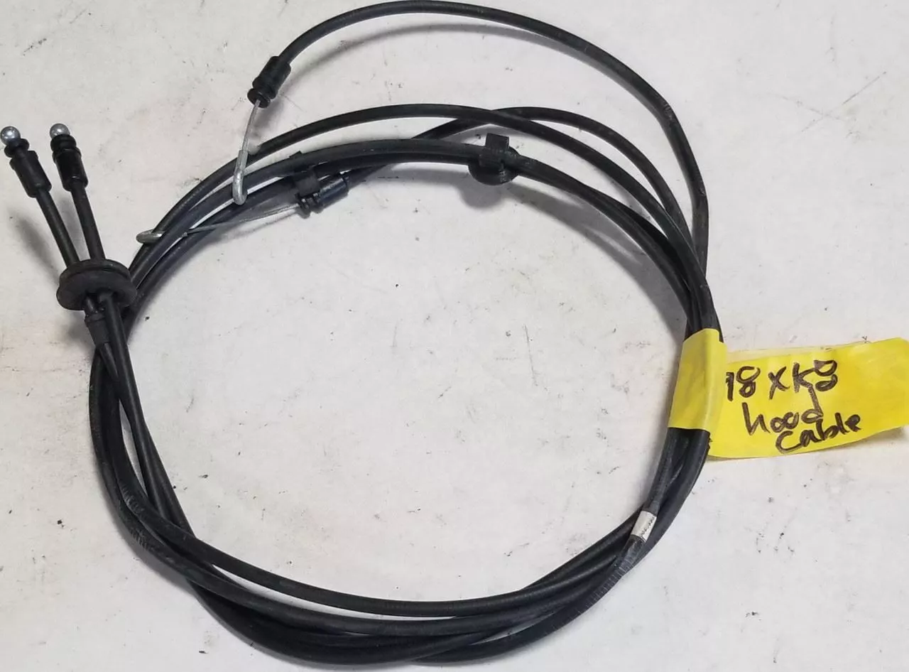

The hood pull cable is essentially the same as two brake or throttle cables on a Vespa. My first line of attack would be to resolder an end on the frayed cable and reattach. Short of that I would then re-engineer the cables to be attached to one another, but that may over-stress the single cable that is still attached. The RIGHT way to do it would be to get a used one and reroute it, but that could be a pain through the firewall. Here's a picture of the cable you need and what the ends look like.

Note that attaching the housing is just as important as the cable itself, else the cable will not slide well through the housing. It needs to leverage against itself.
