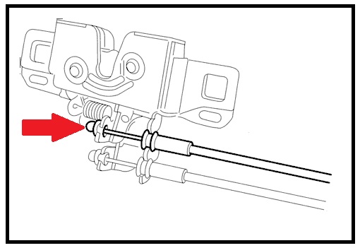

Alternatively, cut the end off and replace with a Bowden cable solderless nipple to shorten the cable:
Yep it's strange isn't it. Like I said above, I can move the internal cam on the key end manually, and that isn't enough travel. Theres about 5mm too little travel at the latch end.
that bowden cable thing looks like just the ticket, thanks!
