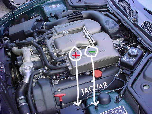

I just purchased a 2004 xk8 conv. I want to use a trickle charge unit on the battery. how do I get the lights in the trunk to go off so I won't drain the battery at the same time I'm trying to maintain the charge.

Connect the charger under the hood to the fuse panel feeds
Compliments of Paul Pavlik
