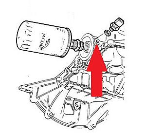

The oil pressure sender is screwed into the side of the filter mounting. Here is the illustration from the Parts Catalogue showing the sender and washer top left with the location arrowed in red:
Not necessary to drain the oil to replace it although you should take the precaution of first waiting for the engine to cool.
Another cause of slow pressure build up and erratic pressure can be the wrong oil filter. Are you using an OE Jaguar filter (which has a non-return valve) or an aftermarket filter with a non-return valve?
