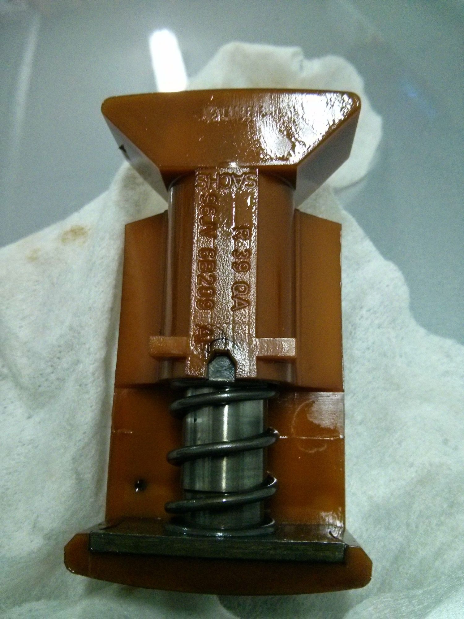

When I did mine at around 40,000 miles, there were cracks starting to appear on the other side of the tensioner (see photo below). Yours may well be the same. While you have the valve cover off you should replace that secondary tensioner using the zip tie method and do the same for the other side. You might want to drop the oil pan to check for debris before deciding whether to go further and do everything which is a much bigger job than doing the uppers.
mmm-hmmm
just shy of 50k on these ones from 2001 (changed last year)

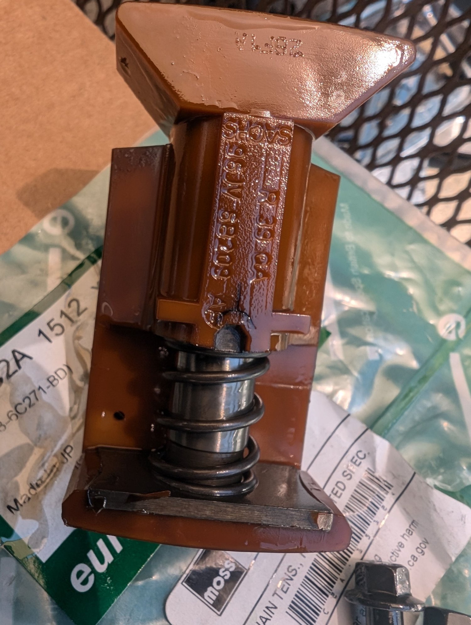

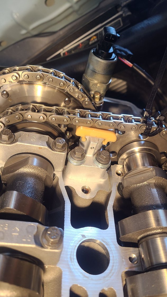

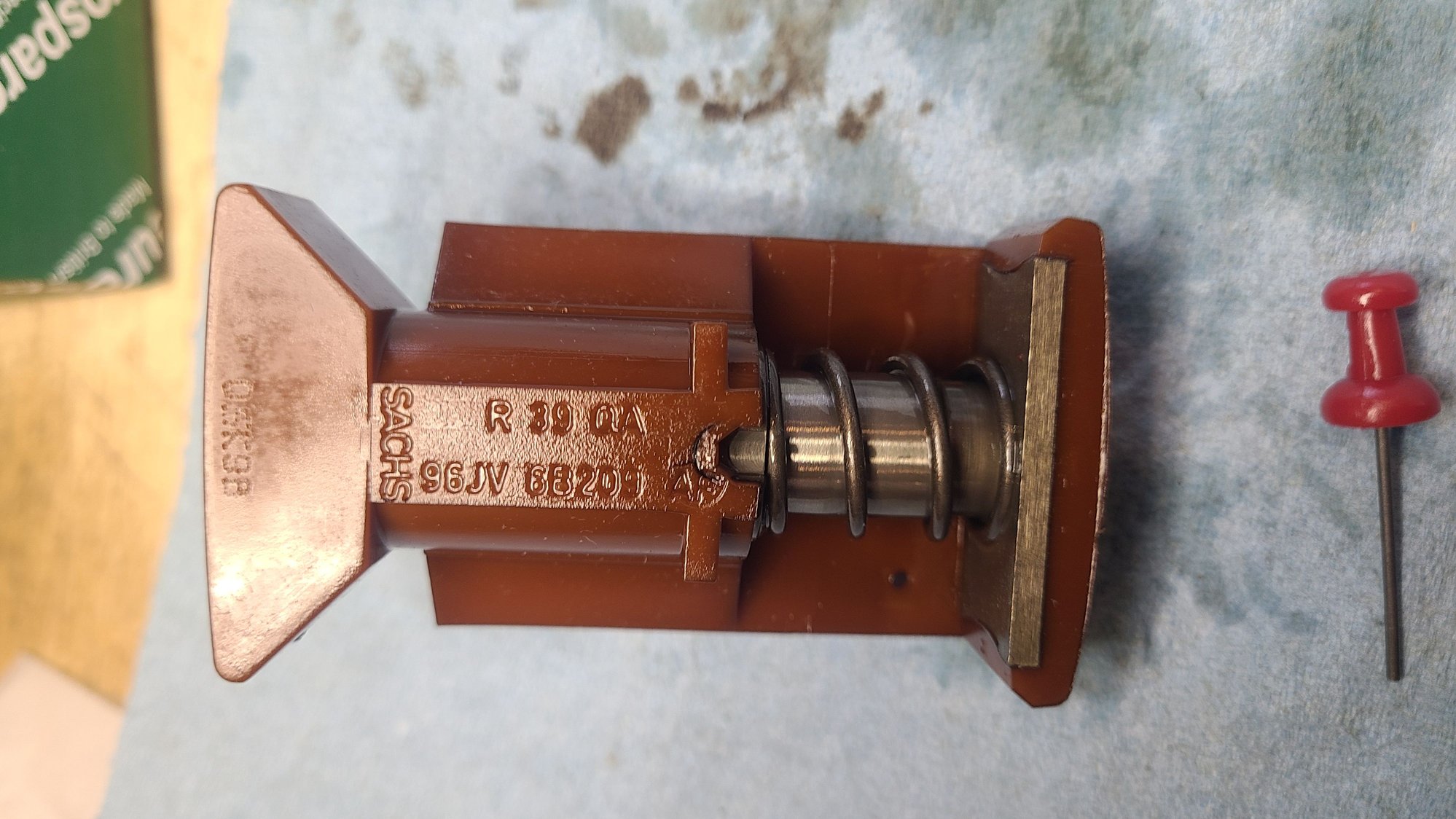

I finally got around to replacing the right side tensioner. The old tensioner had no discernable cracks, but I'm glad I am replacing the old tensioners with the upgraded metal bodies ones. It is worth the peace of mind. The bolts sent to me by Barratt, and the only ones listed in the (paper) parts catalog for these tensioners were longer than the originals, not the shorter bolts that should go with the new tensioners! So I reused the original bolts with a few washers under the bolt head to make up the difference. I'll go to the hardware store tomorrow and see if I can get M6x35mm flanged bolts, and replace them before I close it up and do the other side.

Your photo certainly shows what looks like a crack starting in the usual place on that plastic tensioner, but I doubt if you would have got another 25 years out of it without failing.
