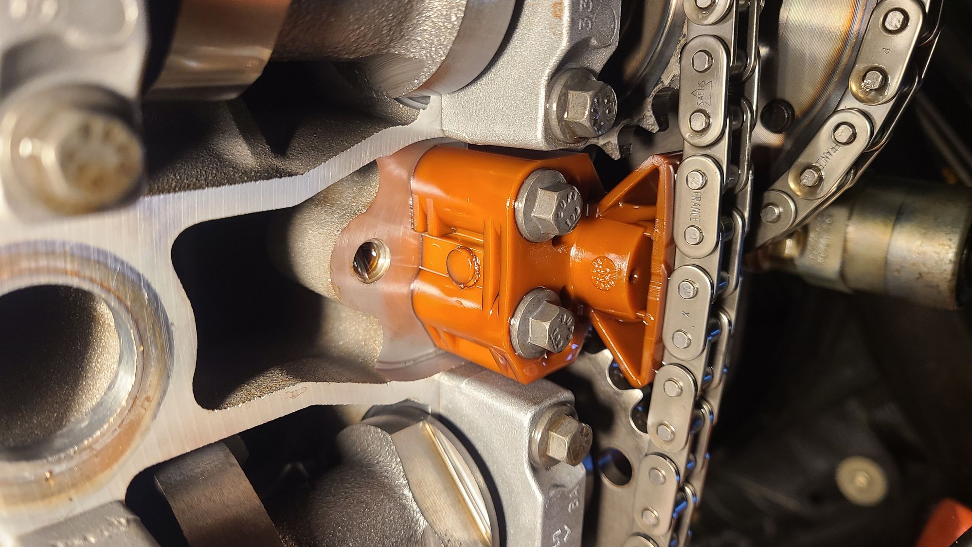

Old Mar 30, 2025 | 03:26 PM
Astrobill's Avatar
Joined: Oct 2024
Posts: 26
Likes: 6
From: Valders WI USA
Default Plastic tensioners still around in 2025
2000 XK8 30,000 miles.
Ok I gave up on the boroscope approach, and took off the valve cover. Look at that, an original plastic tensioner, in 2025! Who would have guessed? And it's in great shape, but for how long? Looks like I'll be doing an upgrade.
Old Mar 30, 2025 | 03:33 PM
NBCat's Avatar
Posts: 6,068
Likes: 2,983
Given the age of the vehicle, replace the primary chains, tensioners and guides as well as the secondary chains and tensioners. Quite often the primary guides and tensioners have cracks or missing pieces of plastic that find their way into the sump, so that should be removed as well if there is evidence of broken primary tensioners or guides.
