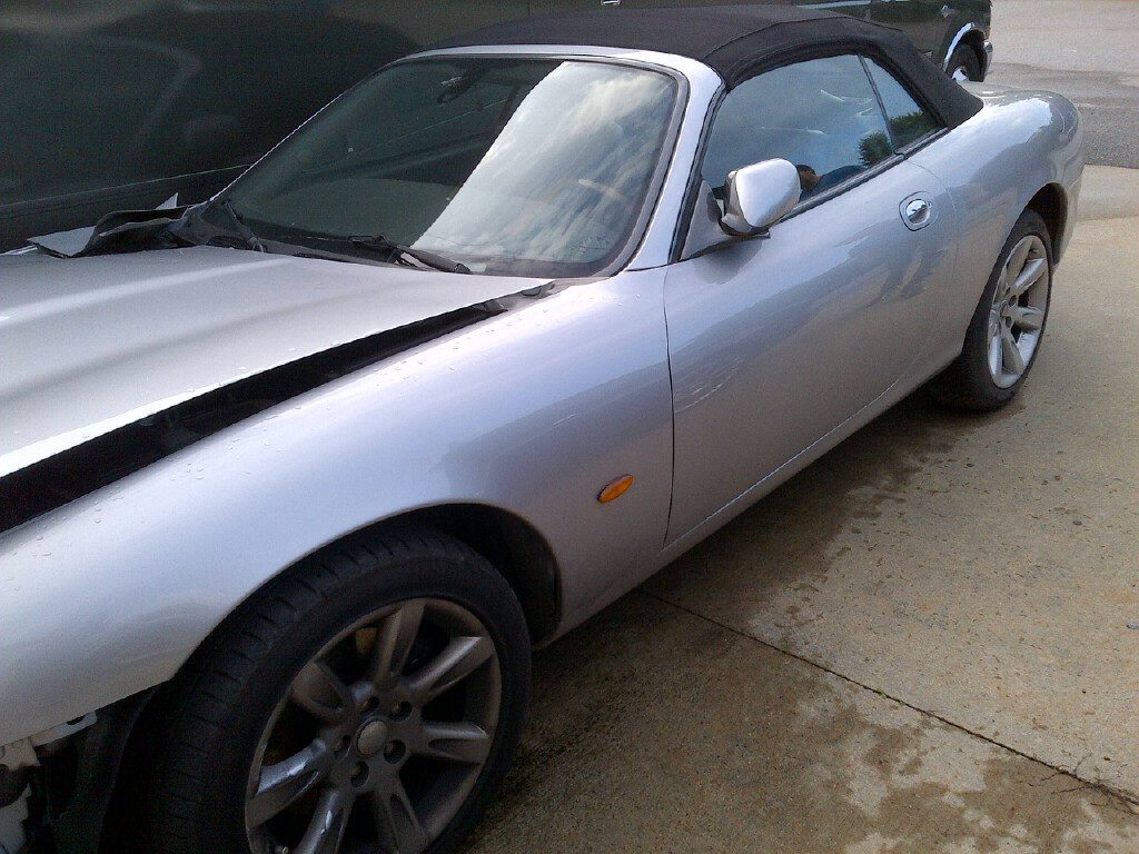

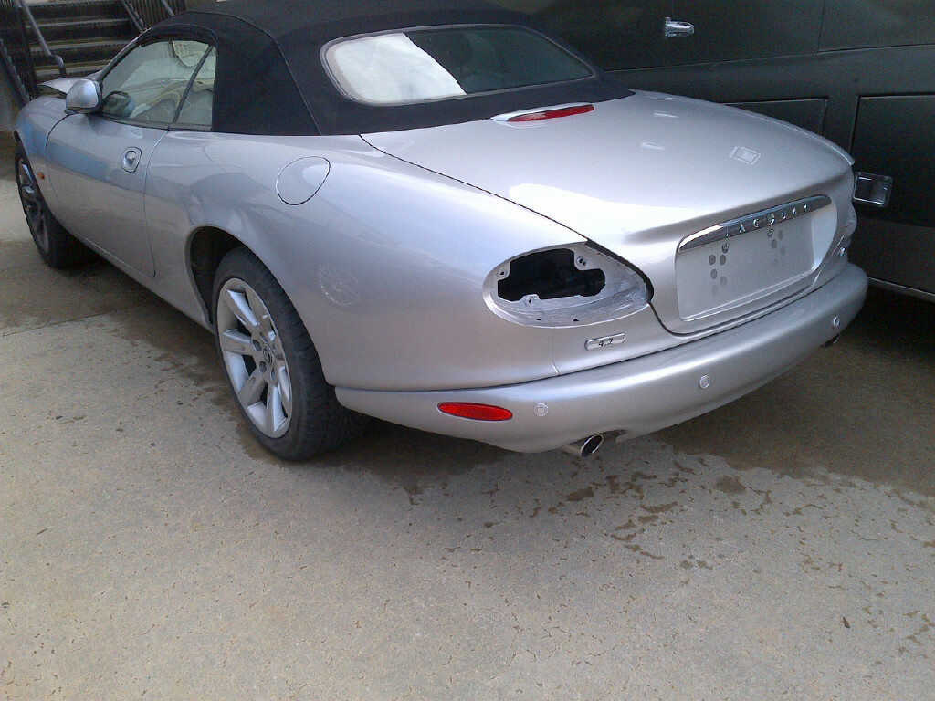

[IMG][/IMG][IMG][IMG][/IMG][/IMG]I got the module and now everything is working fine. I got it from Eurosport Fine Automobiles in Cumming Ga. It's a great place that restores old XKE's and a lot more. Andy is the owner and he was very accommodating. They have a 2004 XK8 convertible with 30000 miles they are parting out and some parts left from a 10000 mile 2001 XK8 convertible. Here's his link esportauto.com. The parts cars are not mentioned but give him a call and he will work with you. The 2004 has a very nice black interior.
