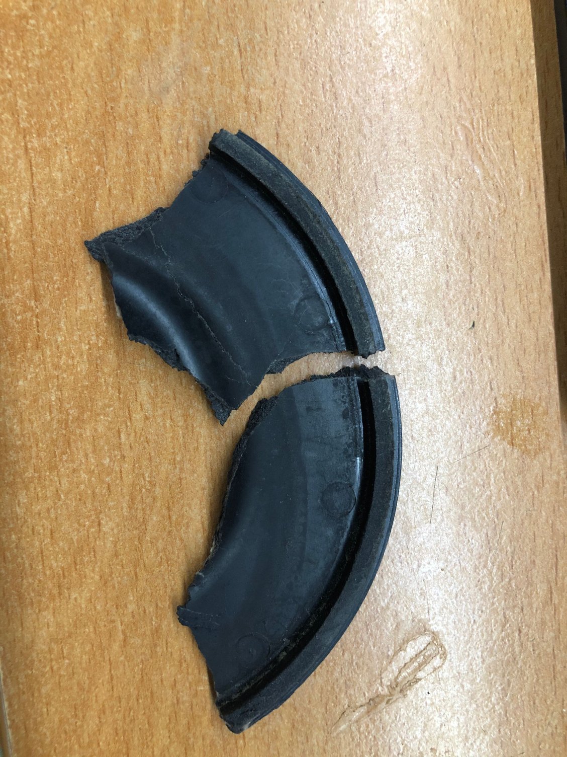

Also, in looking around the car, I found plastic bits - photo attached - which I believe will match up to the bit of plastic in the throttle body.
Can anyone identify the part of the broken part?
Is the engine toast or might I luck out assuming the engine hasn't swallowed too much plastic?
Thank you.
Found on the ground near the '97 XK8. Possible match to scrap found in throttle body.

Thank you. Upon cursory inspection of the intake tube, I found a crack, but not a missing big circular plastic piece. Really hoping I can find such a part, up or down stream - again assuming the engine hasn't swallowed the lot of it.

A ruler or scale next to the image in your photo could help with identification.

Perhaps 4.5" in diameter. Origin unknown.
....It exactly matches the diameter of the throttle body. But I've never seen it before.

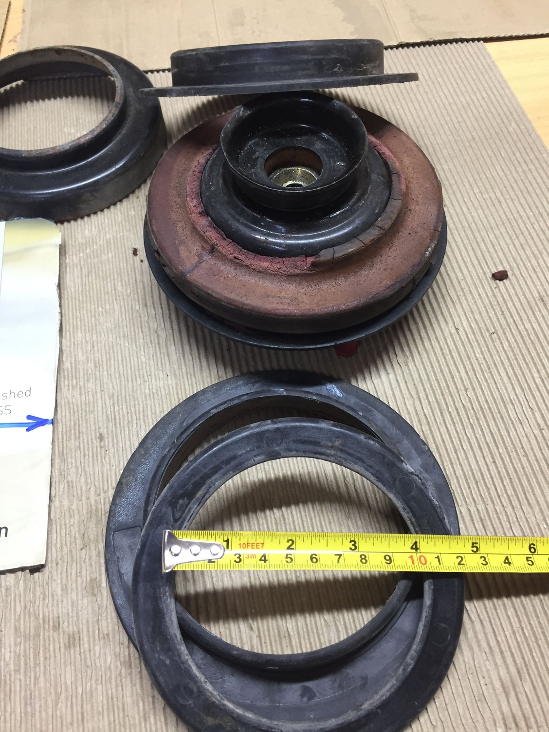

Default Think the bit on garage floor is from suspension
Nothing in my 99 XK8 air intake looks like your photo of plastic bits.
I suspect bits from the garage is from your suspension. Diameter is about right. See pic below.

David, I think you might be right about the suspension bit. That is a known issue in need of replacement that I hadn't yet tackled (read, was avoiding). But I'd never actually seen the part - until now.

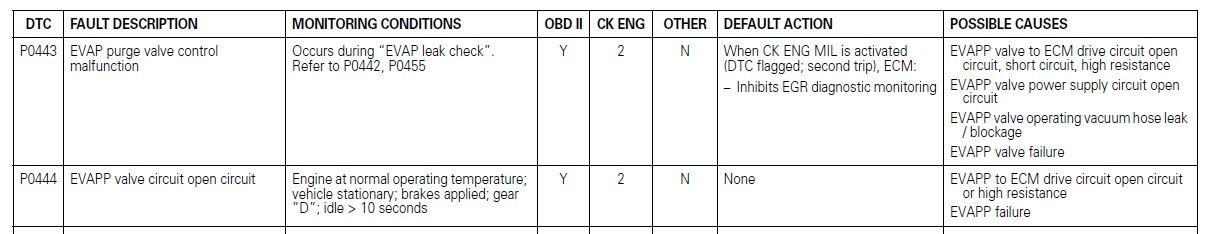

Here's an excerpt a 2000 MY DTC Guide for your P0444 DTC.
If you're unfamiliar with the EVAP system, it's basically a system to recover and use fuel vapours. Looks like P0444 is a possible electrical short between the EVAP and the ECM. Most common failures I've seen on this Forum is P0445/P0446 related where the EVAP Purge Valve (behind the front left wheel well) goes bad. Also someone recently found that there's a Tank Pressure Control Valve that went bad.
An easy (emergency) way to get by/check this is to take off the fuel filler cap, stick a big screwdriver to open the internal flap and let the tank vapours disperse - some say they had to wait overnight. Safety first - No smoking or naked flames nearby - not even turning on a light switch. Then try starting the car.
