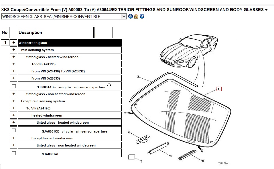

Sorry to hear about the breakage and the inconvenience of a wasted day.
Checking the Parts Manual, although all convertible windscreens are the same shape and would physically fit, there's a change in Part Number for those with rain sensing wipers when the aperture changed from triangular to round.
This means 3 different patterns - 1 x non rain sensing and 2 x rain sensing. Worth a close inspection for an exact match with the old one before they start.

The metal clip no.3 is no longer available but replaced with a later plastic type, for obvious reasons, they rusted away!
The clips are fitted around the screen before it is fitted...... The US car here has had the trim glued in, completely knackered it trying to get it out, no clips were used, because of this the screen is actually about 6mm off centre...... not the best screen fitting in the world but maybe one of the worst!

Thank you for the information on the clips. I was able to instruct them about what to expect, and they brought bigger, sturdier new clips that are universal in fitment, so they worked very well. Your post was invaluable.
