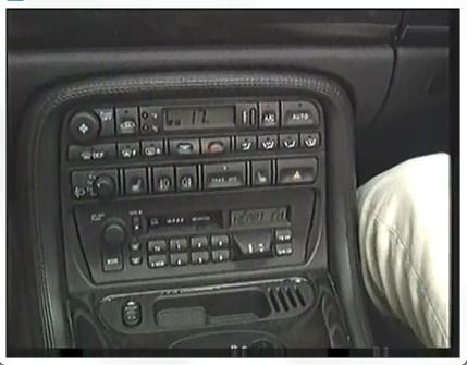

Many people have antenna problems so you're lucky this works! It's worth checking the radio isn't stuck in the wrong mode before replacing it. Your's is a 97 (right?) so it could have the early head unit with the four way flipper control:
or the later type with buttons:
Did you get the Audio Handbook with the car?
Does the display show any info?
Does it cycle between Radio / Tape / CD?
Do the steering wheel buttons operate?
The ON/OFF button doesn't actually make a click when pressed to power on and off but there is a definite resistance you should be able to feel if the button is OK. It rotates for volume adjustment. On the later units, you can keep turning the control either way with no stop and I think the very early ones were the same but it's been a few years and several different cars since I had that type and I could be mistaken.

What is meant by "head unit"? Is that the entire radio? How do I check other flippers as noted? The radio stays in the same band always (like it is stuck there) and has lights but no sound or ability to change channels or bands. The on/off buttom does not seem to have any resistance (cannot tell when it is on or off). The radio does not respond to any of the buttons.

Radio is on and the display illuminated but NO button has any reaction? That's more than just a possible ON/OFF button fault. Pressing the four-way tuning button either up or down should put the tuner in 'seek' mode. If it was just a volume control fault, at least it would move off the set station.
Check the harness multiplug at the back (J gate surround and centre console have to come out to be able to remove the radio). If this is secure and there's no breaks in the wiring, you're looking at finding a replacement unit.
